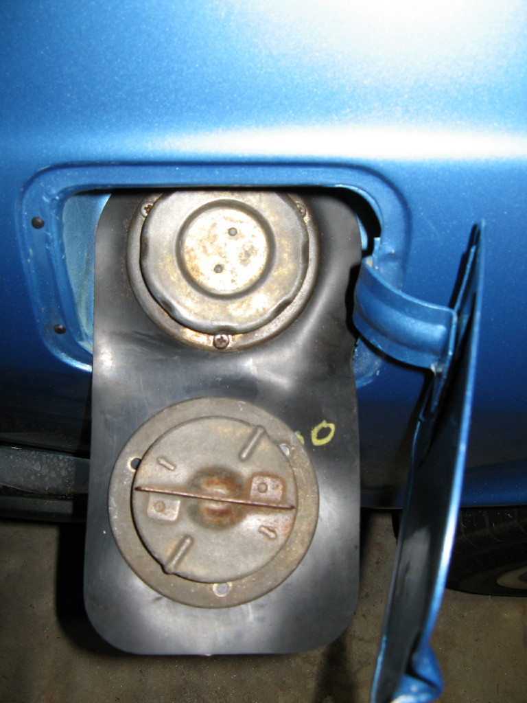

I have an extra gas cap that I can send you. The extra cap does not match what's on my car so I'm not sure which is correct for yours.
The attached picture shows both together. The 3 screw holes line up so it will probably fit any 240Z.
In Mike's picture, the top cap is correct for an 8/70. The one without the metal tab - thumb tab. The cap with the tab is much later - 4/72.
The cap without the tab came in two varieties; without a chain and with a chain. 17251-E4101 and E4102 The cap Zhead is refering to is E8800 or E8801 with a chain.
