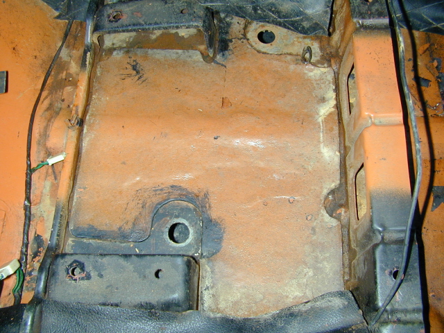

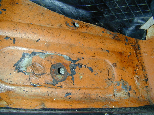

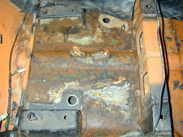

July 2, 200619 yr comment_173123 Here's a link to a search with "Dry Ice" as the terms used. Hopefully it doesn't bomb out on you: http://www.classiczcars.com/forums/search.php?searchid=260504 If it does, just key "Search" above and type in Dry Ice. That's one of the EASIEST and QUICKEST ways of removing that Tar Paper that's attached to the floor panel. That answers the "HUH?" part. However, you won't know if in fact you have "YAY!" until AFTER you remove the tar paper. Unfortunately, there have been countless instances where the Tar Paper looked great....but the metal below did NOT. Here's a couple of pictures to illustrate what I mean. The Left Most is the area below the Passenger Seat...didn't look TOO bad. There was some rust to be expected (look at the forward side edge) but as you can see from picture number two.....YIKES! Then look at picture number 3...."OH NO! More of the same?" Then take a look at number 4...."OH! Not as bad as I thought it would be". All of that damage you see, is quite easily repaired. It's when you start seeing holes that you have problems.... Hope I didn't burst your Yay bubble too hard. Enrique Link to comment https://www.classiczcars.com/forums/topic/20636-yay-and-huh/#findComment-173123 Share on other sites More sharing options...
