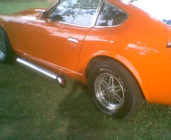

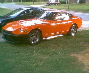

hi alll intro myself i am a proud owner of a 1976 280z that i inherited from my grandfather when he did it was a one owner car i had been after it a while but need less to say yes i love z's but i now own 2 of them same year and model the one i drive is alll origanl only had 5000 miles on it and the one i fixed up in the avatar is one i took out a junk yard as soon as the other comes from paint i will post new pics and thanks for acceptance to your community this was a complete restoration on this one alot alot alot of raust LOL but she look like new now all left is the floor pans when they get in but i got a leak and cant find it when it rains water drips on my leg on the driver side any one can figure what it ispost-11991-14150797790973_thumb.jpg
