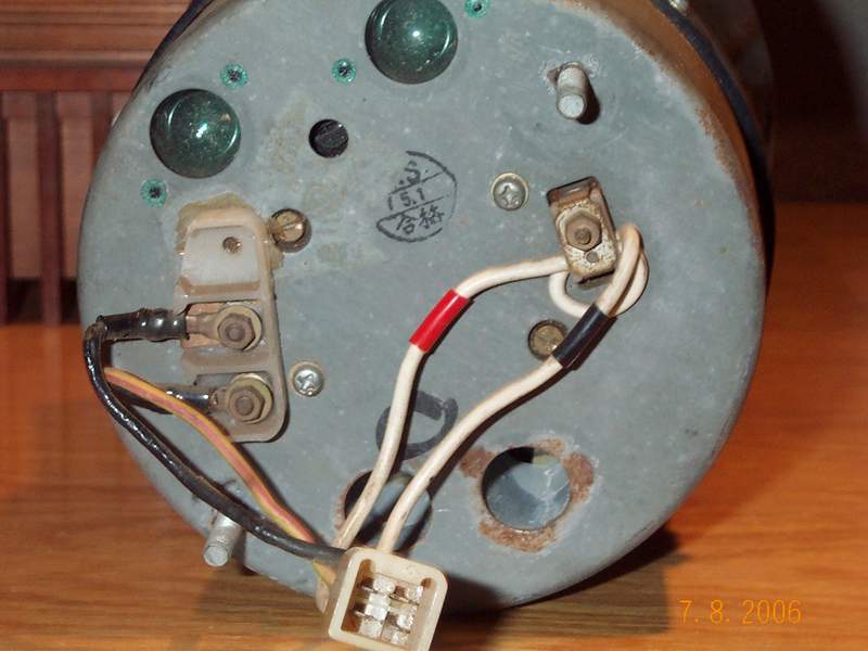

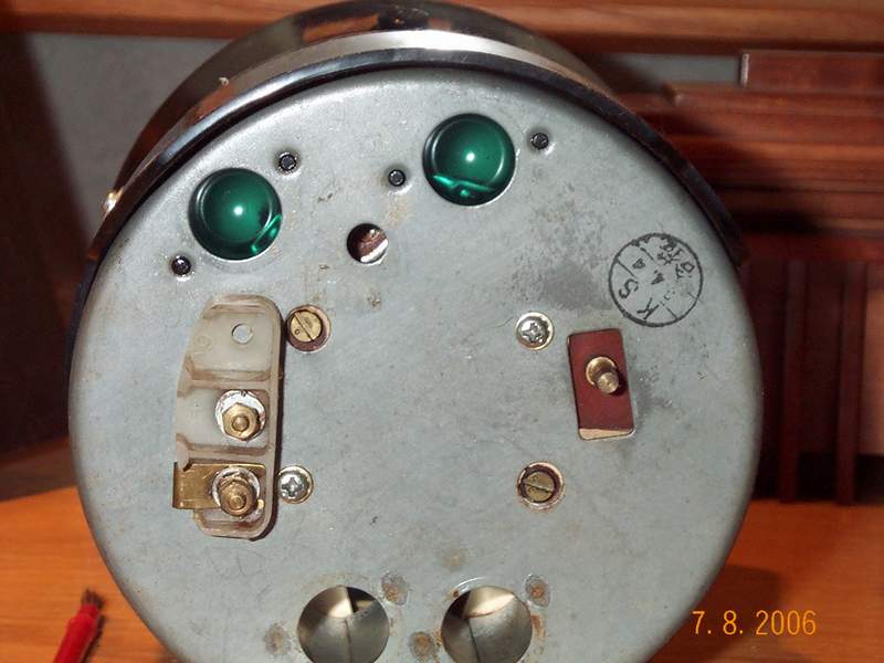

Also---I have attached pics of the rear of the tachs. To connect the 280 tach to the harness can I cut into the black and red tagged loop harness of the 240 tach shown and attach a female bullet connector so that it will clip onto the single pin of the 280 tach and still retain the white connector for the 240z dash harness? Would this work properly?
Finally---is the 240 tach a three wire or a four wire and are both of these tachs negative trip type?

The tach with the wiring still attached is a "4 wire" tach. Note the white wire that "LOOPS" around the screw on the right hand side of the case. This white wire has two connections in the connector visible there. These connections are to the Black/White and Green/White wires that go to the coil. It is through these that the tach senses the discharge at the coil.
It is these two wires when NOT connected that cause problems with the ignition, and give rise to the myth that the car will not run without the tach IN the circuitry.
The other two wires are the ones that provide the power for the tach circuitry.
The second tach looks identical to the first but with the wiring removed.

Looking at the tach with out the wiring is identical to a three wire tach I have from a 74 260. Wiring according to 74 FSM ,top screw post (green) to 10 amp fuse, bottom screw (black)to ground.The stud connection to coil negative.There is a resister in this line between tach and coil .Looking at a MSD wire connection diagram use coil positive to MSD red wire,MSD orange to coil positive,MSD black to coil negative. The MSD white connects to dizzy Your 4 wire tach should be ok as in the ignition feed to coil positive

Thanks for your post. My tach is like the picture with the wiring harness attached. The picture on the right is apparantly a 280z tach and is NOT the same tach as the one on the left. They look similar though...
Question is: Are the 240Z tach internals the same once you remove the white wire inductive loop that is looped around the stud on right?
