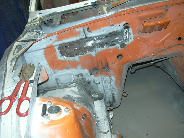

No rust converter... just original primer, possibly some primer from a respray and paint from a respray. That's it. Outside of carpet, paint and recovered seats she is original with 291,000. Virtually no rust... all the usual floor pan and battery tray rust is non existant, just a little starting to pop up on the RH dog leg.
Nate
Nate:
The underside of the cowl does show a bit of surface rust beginning, just to the edge of the Right Hand Side foam padding. You might want to address the whole underside before it causes any major problems.
Now that you've removed that part, and cleaned out the cowl bucket, take the next step and remove both front fenders. The cowl drains into those spaces and it is there where you will find the accumulation of debris that causes rust in the front fender by the rocker panel.
