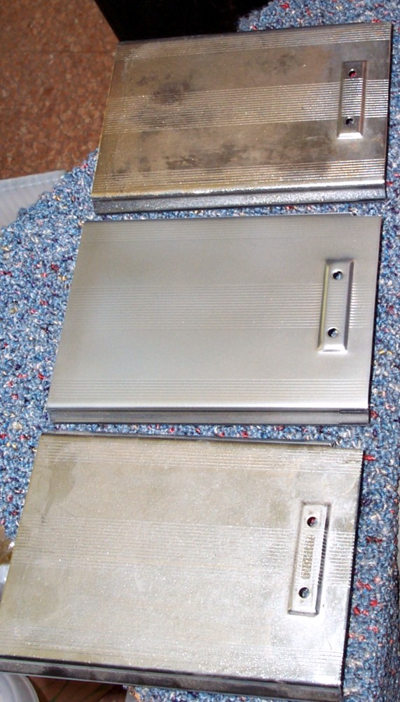

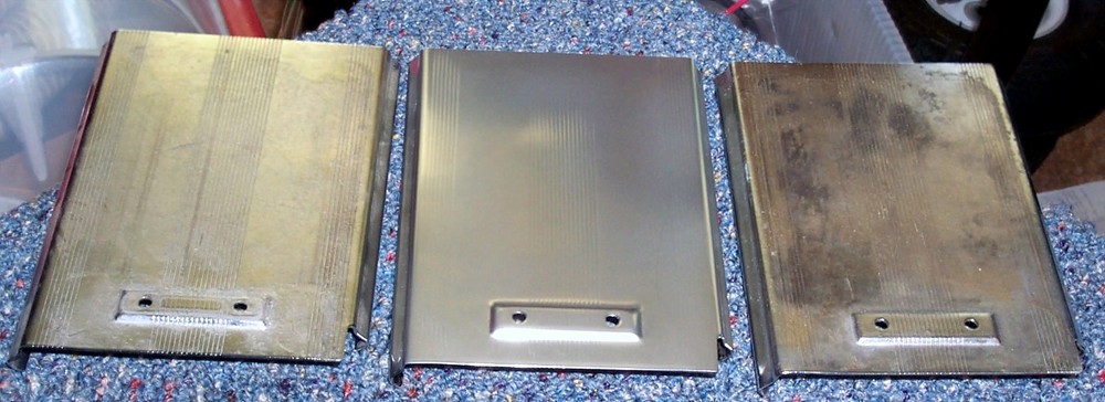

Ok, after a particularly exhaustive search of the archives, a trip back through Mr. Humbles book, a lenthy google search, and several attempts of my own. Has anyone been successful at restoring the finish on the later 240z Chrome ashtray cover? (removing the scratches and wear on the chrome)
I have tried:
1)Metal Polish-probably the most successful non-altering precedure-does nothing to the scratches, but does brighten the plating.
2)Chrome plating-new chrome stays dull, but fills in the embossed texture on the cover-thus altering its appearance in both texture and reflectivity and brightness. It does look good, but does not match any other finish in or on the car.
3) Media blatsing with:
Plastic media-no significant change.
Sand-YUCK what a mess
4) Stripping the chrome and then nickel plating.
5) painting with copychrome(works fairly well, but does change the texture as it hides the scratches)
6) Stripped, plated with copper, sanded/polished until smooth, taped up, sand blasted, and rechromed-gets really close, but evidently a different media was used. Still not close enough to pass side by side.
Anybody got one that works?
Will

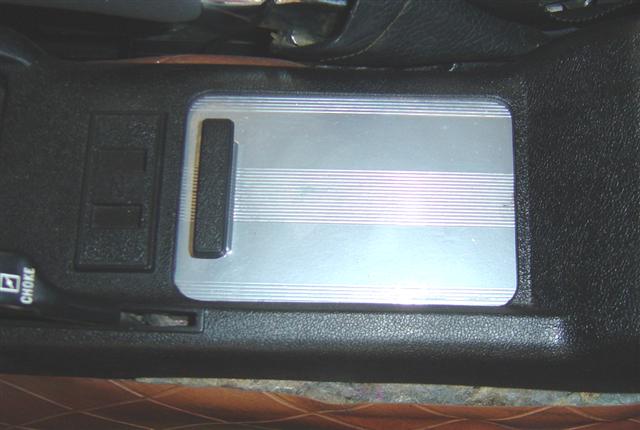

I did mine in chrome powdercoat. Not perfect, but I like it.
That looks pretty much like the re-chrome looks-I thought it had been powdercoated when I picked it up-but no, they showed me progressive pictures of the process.

PS, I'll post a pic of an original and the rechrome after lunch

The plater has tried just adding chrome, stripping the piece down to bare steel then tripple chrome, and what it looks like to him is the copper plate was taped and media blasted before the chrome was applied-that is to say the texture is in the copper, and not the steel below it. The problematic part of the entire thing is the process is being done to remove the scratches in the chrome which are as deep as the texture, so any coating obscures the texture.

Note that there are fillers/solder that can be used to fill the scratches, which can then be plated over. That might allow a for a thinner copper plate and help prevent the design texture from getting filled in.
You can get it repaired and replated for around $60 plus mailing charges at a plating company near me. While that may sound kinda expensive consider it is NLA and you typically can't find used in good conditon. If everything else is really nice then why skimp here? It all depends on what you're looking for in the finished product.
