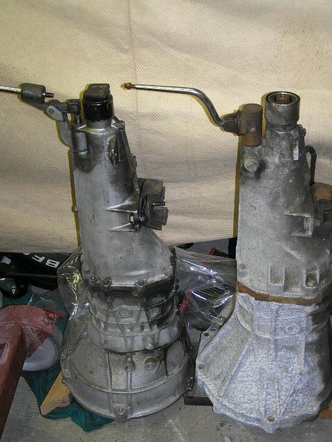

ZSaint Posted July 24, 2006 Share #2 Posted July 24, 2006 Here is a pic of both trannies. The 5-speed has a larger/longer case. Link to comment https://www.classiczcars.com/topic/20922-5spd-vs-4-spd-visual-difference/#findComment-175744 Share on other sites More sharing options...
Walter Moore Posted July 24, 2006 Share #3 Posted July 24, 2006 BTW, the 4 speed in the previous picture is from an early Z car. (70 - 71)The late 4 speed looks like the transmission on the right in ZSaint's picture. The 5 speed is longer however, and takes a different drive shaft. At least that is what the Hanes manual says, I have never seen one.I just know that MY 4-speed looks like the transmission on the right. Link to comment https://www.classiczcars.com/topic/20922-5spd-vs-4-spd-visual-difference/#findComment-175749 Share on other sites More sharing options...

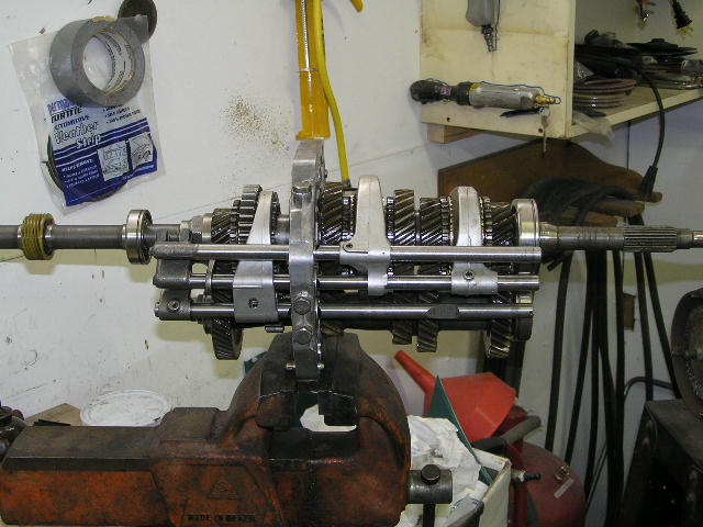

ZSaint Posted July 24, 2006 Share #4 Posted July 24, 2006 Here is what the 5-speed looks like on the INSIDE. This is the rear unit for the 5-speed. It will tell you whether you have a 4- or 5-speed. The 4-speed came out of a 2/71 '71 Z. The 5-speed came out of a '83 Maxima. I used the original driveshaft (w/new u-joints) when I installed the later 5-speed. Link to comment https://www.classiczcars.com/topic/20922-5spd-vs-4-spd-visual-difference/#findComment-175760 Share on other sites More sharing options...

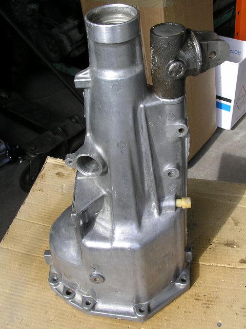

Darrel Posted July 24, 2006 Share #5 Posted July 24, 2006 This is the later 4 spd, note the height of the pivot hole Early 5 spd. note the lentgh of the shifter ears and height of the pivot hole Late 5 spd, note the longer length shifter ears and the height of the pivot hole. If you have a late 5 speed you can make a short throw shift mod without paying the $150 for the msa short throw kit. Redrill the longer ears on the shifter ears on the tranny then cut the bottom portion of a 4 speed shifter and drill and tap for a stud to lengthen. Check out the pics in my gallery for the mods. There are other differences but these seem to be pretty consistant. Link to comment https://www.classiczcars.com/topic/20922-5spd-vs-4-spd-visual-difference/#findComment-175771 Share on other sites More sharing options...
