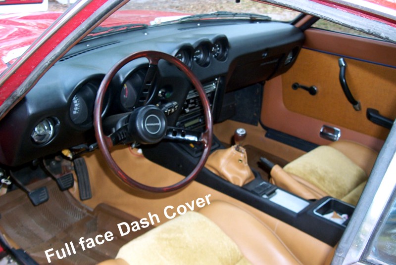

Here are the pictures from the site:
Will

Thanks guys, very helpfull info, I cant use velcro cause the drivers side near door around the corner is way away from the dash, I cant really tell where I have to trim yet to get it to fit right/flush. I got this from Motorsports. If that makes any difference. It looks like I have to secure the center first, then do the drivers side after the center is set up.

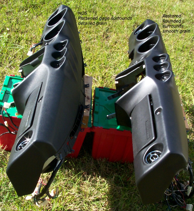

There were four distinct dashes for the S30, two for the 240Z and early 260Z, one for the late 260Z, and one for the 280Z. I have a '70-'72 and a '73-my '73 240Z had a '72 dash in it, I didn't figure it out until I bought the other one from MSA and it would actually fit the dash-so I have a '73 cover new in the box. If yours does not fit close, you proabably have the wrong one. There is a difference in the distance between the gages, and they are absolutely not close to interchangeable... Again, I have both 240Z full dash covers, so if you are not sure what you have, let me know and I will pull the one out of the car and do some pictures of both to document the differences.
Will
