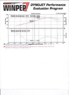

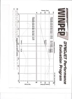

Gonna try and attach the dyno sheet , dont know if it will work I scanned it, but never had su's on this it was a package deal I bought after the 77's motor got trashed (son). Timing may very well be the problem, found yesterday that the elect fuel pump was out and only the mechanical was working, and it wasnt good , fuel pressure floating between 1.5 and 4 so fixing that first. and moved the timing to 12btdc and see what happens! it was at 22 from PO.
Hpefully bigger and easier to read
On the timing issue you'll probably want full advance in the mid to high 30's. You can test this on the dyno and figure it out. If you have a timing light with an advance dial you can figure that out just by setting the light to say 36 degrees, revving the car up to 3000 rpm and then setting the timing to hit the 0 mark on the pulley. Then you can adjust it on the dyno to get it dialed in right where you want it.
I'm guessing it's the way that the rest of the motor is built that is holding you back. Timing might help to optimize what you've got and you might pick up a few hp, but I think you're going to need to step it up in the compression or cam area (or both) to see a bigger jump in hp.
About 120 whp would be what I would expect from what I've seen on the net, but I've never dyno'd anything. Never had the $$$ to spend on a dyno. You might consider a Gtech or other similar product as they will give you 0-60 and hp estimates. At least you can tell if your last modification helped or hurt.
