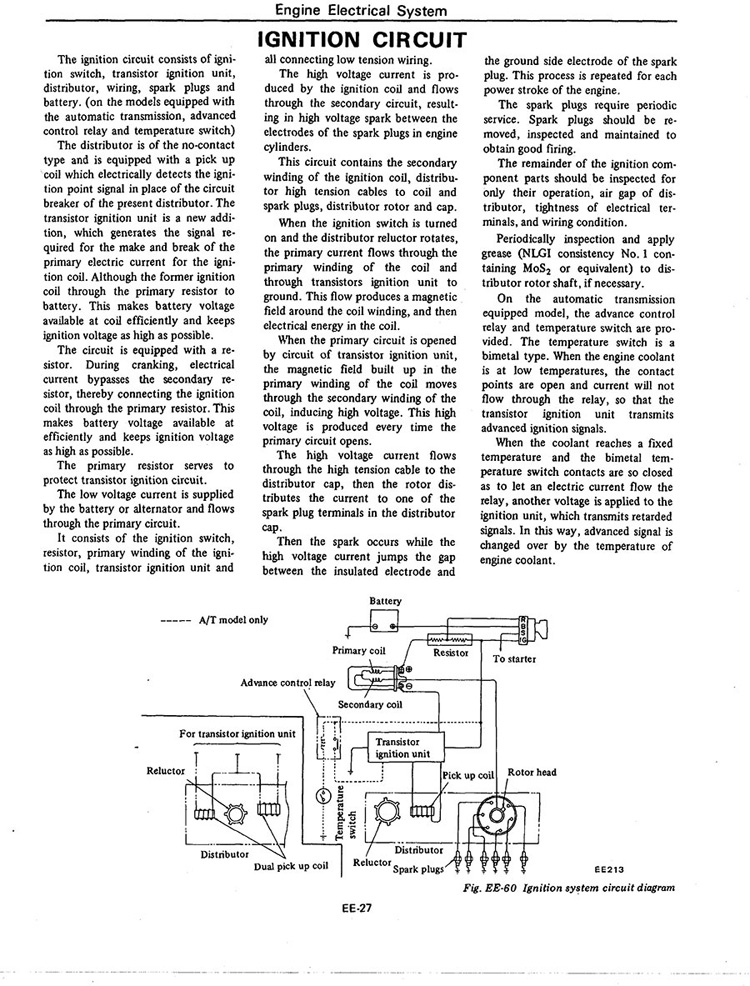

I have the same problems with the tach on my early 74 that I haven't figured out yet.
If your ignition is stock for 74 then you should have the resistor attached per Page EE-27 of the FSM to protect the "Transistor Ignition Unit". It describes your ignition system and its components. Attached is a pdf of that page.
