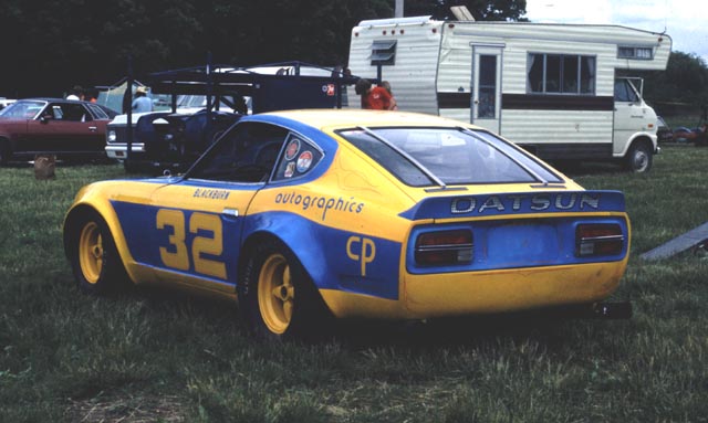

Hi Geoff:
It is believed that Logan's yellow Z racer, which was Red, White and Blue in prior years.. and before that it was the BRE #3 Z. It is still being raced in Vintage events, having been restored to it's original BRE #3 colors etc.
I say "it is believed" because many people believe it. Dan Parkinson doesn't however, as he is convinced that he wrecked the #3 BRE Z years after he bought it from BRE in 73. Others believe that Dan actually bought the #46 car and wrecked that one....
At any rate here's a picture of Logan's car in the late 70's... (thanks to Clark Lance of New Jersey for sending them to me).
FWIW,
Carl B.

Carl, thanks for the background on the Logan Blackburn car. When I saw and photographed it at Mid-America Raceways near St. Louis, it had red/white/blue stripes on hood and fenders and in front of the rear wheels. I thought the car was later crashed at this track by a later owner - did not know that it had any ties to BRE cars. But it was usually the fastest thing with doors at our track. -Geoff
