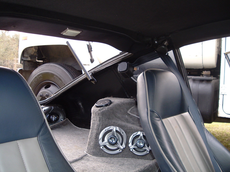

this is not much of a picture but i had mine made custom. they have spools at both anchor points and i used the coat hanger thread terminal to attach a machined metal post to affix the "slide thru" ( for lack of the correct word ) get many compliments on it and it works very well as a daily driver. next time i might use only one spool.....
