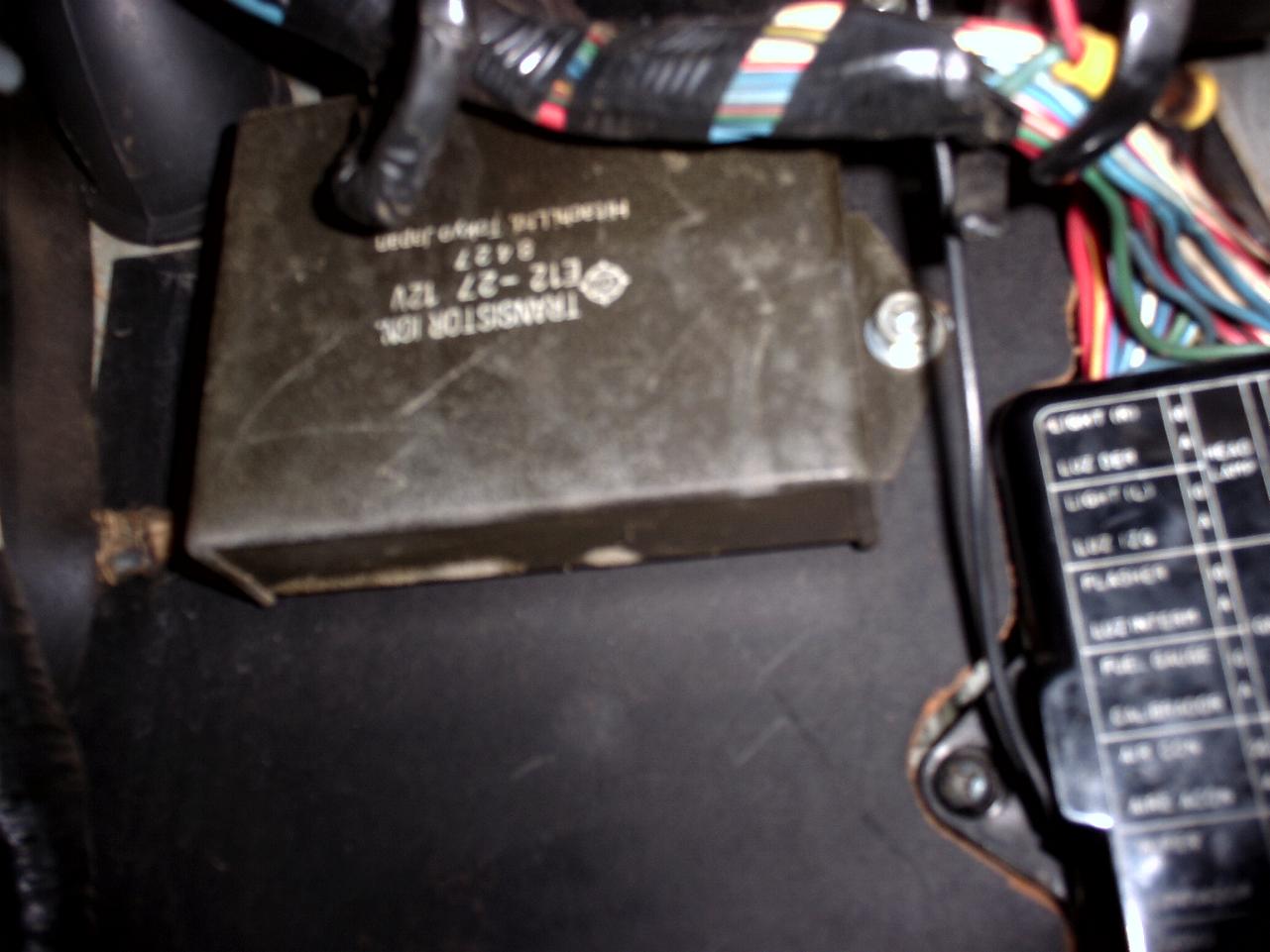

Actually, those are on the 75-78 280Z, US model. In 79, with the advent of the 280ZX, it was replaced by the 'matchbox' on the distributor. But it doesn't look like that picture. It's a black box, located just ahead of the fuse box and is clearly labled 'Transistor Ign'. Evidentally, after looking at my manuals, the box you pictured was only on the 1974 US 260Z.

So what is the picture you posted Stephen? Is it the 75-78 ign module? It's neither the 79-83 or the item bloxman posted. Sorry but it wasn't quite clear to me.

Sorry, Engima, my wording was unclear. The picture I posted is of the ignition box in my 78. And, Blox, I'm not sure how easy a conversion it would be to put the 'matchbox' dist. in a 75-78 due to the wiring involved. Besides, the comparison you quoted is between a 280ZX electronic distrubutor and a 240Z point type distributor. Your 75 distrubutor will work just fine with those Webers. This attachment is a diagram of the 78 and it should be similar to your car. If you don't already have one, check this out. The price is right!
