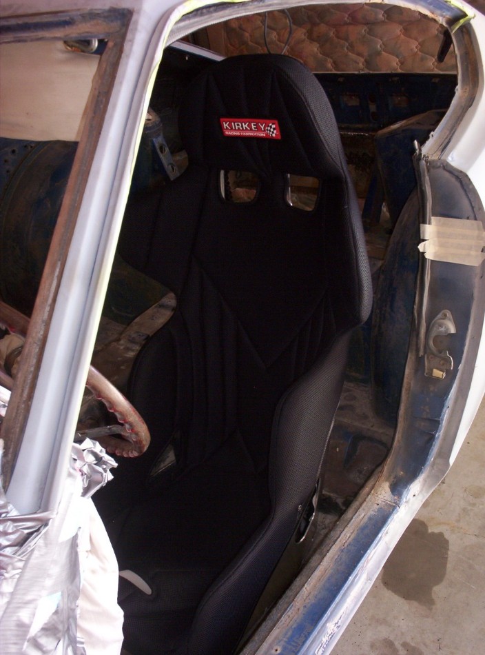

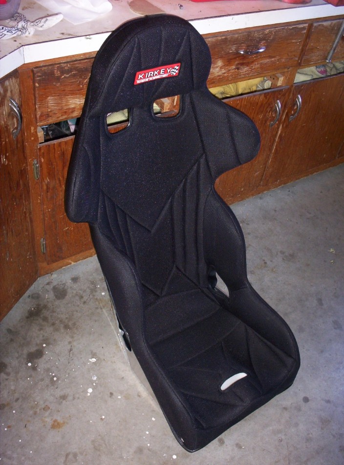

I went with the all Aluminum Kirkey Road Race seat. It only weighs 11 lbs, and you can have it custom built to your body like i did, that way it fits like a glove!!! I went ahead and had my seat cover made out of the air knit cloth it is so comfortable!!! plus you can go 3, 4, 5, or 6 point harnesses. I think i'm going six, but to each his own!
