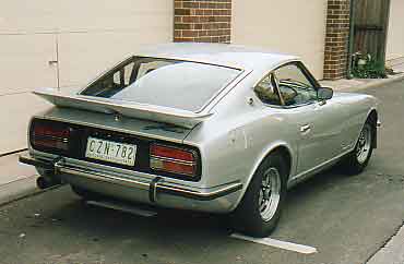

Aussie260z Posted August 26, 2006 Share #1 Posted August 26, 2006 http://www.newgel.com.au/datsun.htmI have the rear spoiler shown in the above link's pictures,It does not have any designated bolt holes,What i was thinking of doing was attaching it with 2 bolts at either end and using some water based polyurethane all around it,That should hold it right? Link to comment https://www.classiczcars.com/topic/21331-attaching-rear-spoiler/ Share on other sites More sharing options...

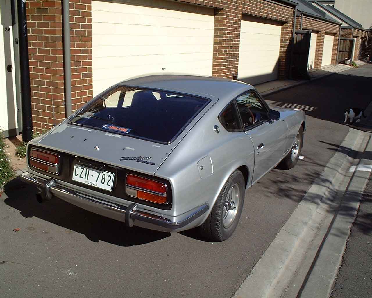

WarrenZ Posted August 26, 2006 Share #4 Posted August 26, 2006 Unfortunately my car had one of those spoilers on when i bought it. It has self tapping screws up through the hatch. 3 at eiter end and 4 across the centre and was also sealed with some sort of butyl putty. It was very difficult to remove so I doubt it would have come loose in normal driving. See the pics for the before and after. You can see where the screws went and the damage to my paint job. Welding holes in the hatch is not easy either. Warren Link to comment https://www.classiczcars.com/topic/21331-attaching-rear-spoiler/#findComment-180028 Share on other sites More sharing options...
