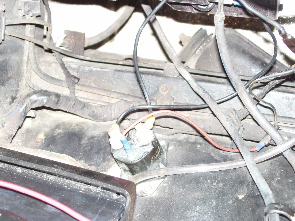

Apologize in advance for my ignorance, but am looking for the fusible link near my starter and I found the enclosed picture. You can see a Ford Motorcraft relay or something before the starter that a PO installed. Any clue what this is for? I can't find the fusible link, or I am looking at the wrong spot! Help!!!
It looks like a previous owner has added a relay to the circuit that energizes the solenoid. No idea why someone would do that, as the solenoid itself is just a big relay.

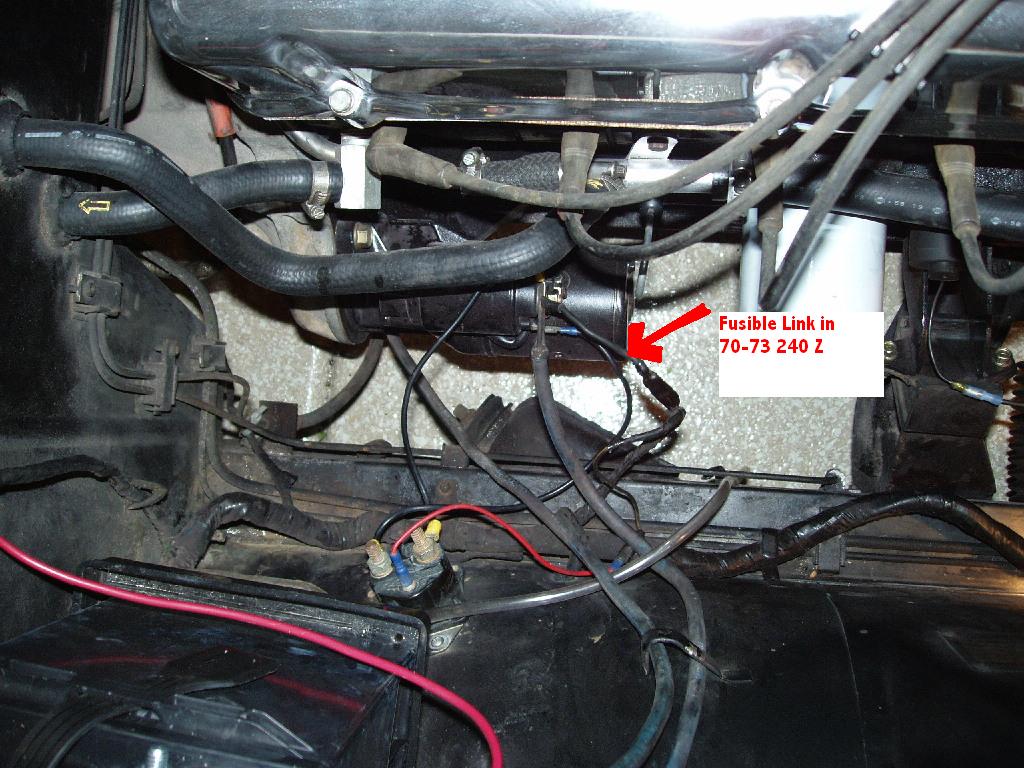

The fusible link is just a special wire, which connects to the same lug on the solenoid as the positive battery cable does - it is about 6 inches long and plugs into the harness. In your picture, it is black, looks like to me.
