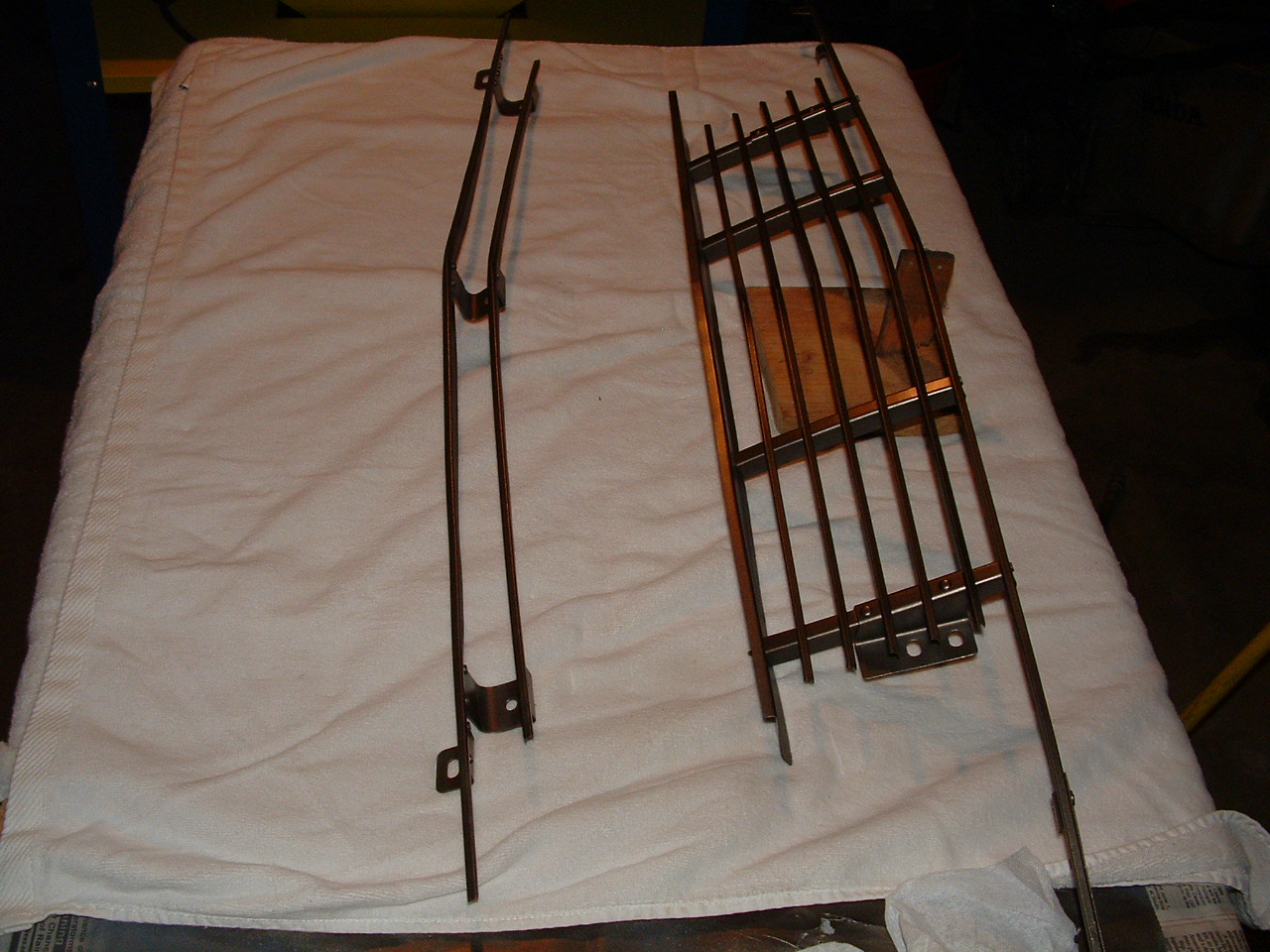

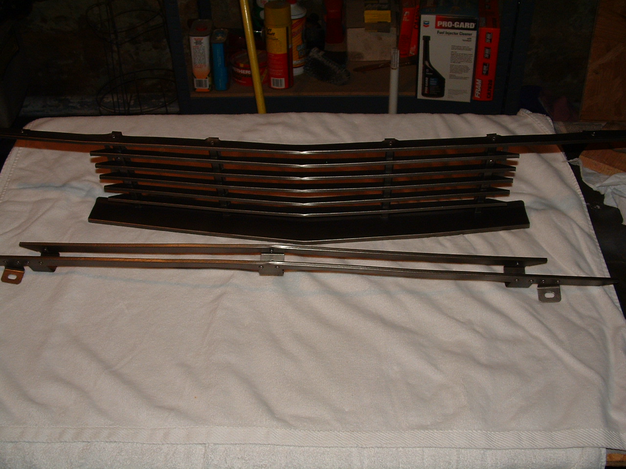

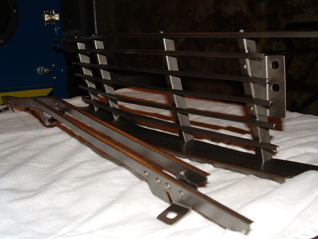

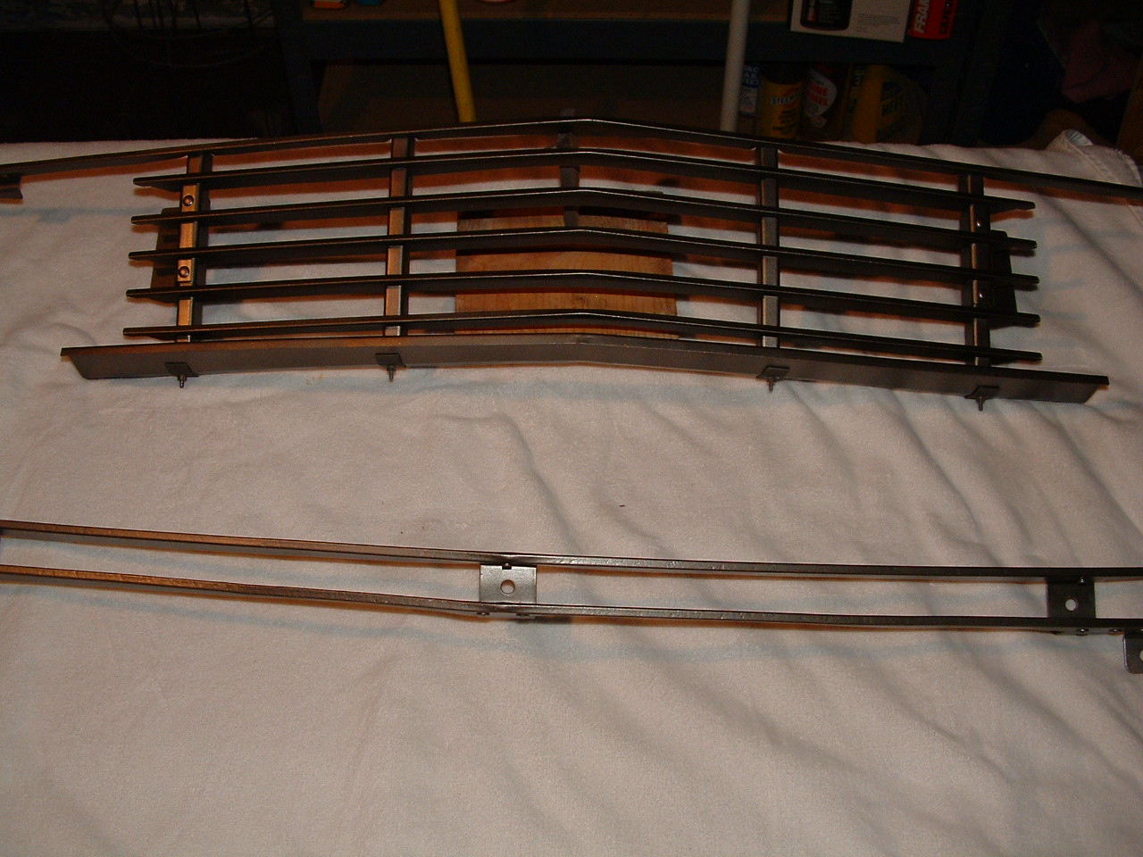

I went to the local Advanced Auto and found its - Its a very close match to the original paint color. Look for Duplicolor Truck, Van and SUV #T415 (BronzeMist). I also used a darker gray primer - Krylon RTA9205 (gray primer).
After I broke the grill down, it took a while to blast and straighten the individual pieces but it was worth it.
