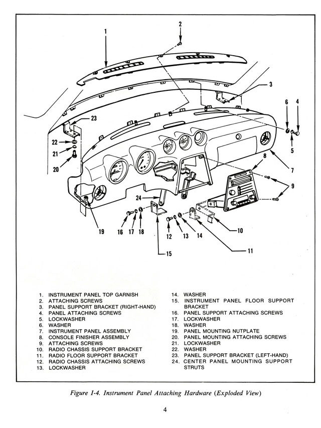

I got my 2nd 240Z (the 1st was in the '70's) last year. It is one of those factory authorized restoration cars (Z-Car). It had a stereo radio in it that I have pulled out and am trying to install an original Hitachi am/fm radio. I have gotten past the huge problem of removing the Heater Controls and Faceplate and finding the proper wires/connections to power the old style radio (the stereo people did a number on the wires). I also believe I have to replace the "automatic" antenna with an old style manual one.
Now my latest problem is that the radio has brackets on both sides but behind the '71 dash there are no corresponding side supports/brackets/hangers to attach them to. The radio will be just "hanging" there unsupported (albeit it is crammed in amongst all the wiring harnesses). This does not seem to be an ideal situation as I can see the weight of the radio moving while under way and putting strong forces on the fragile faceplate and eventually destroying it. Any suggestions?
Thanks, Phil

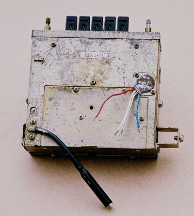

From the factory wiring harness I have a blue fused wire, a white wire and a white/blue wire. Problem is that both the white and white/blue have been cut at the connector and I don't know where they go to the radio? There is a small round female type connector on the left rear side of the radio, I have taken the radio apart and if I jumper a couple of the pins together then I get a light on the front of the radio to come on. So far no sound, but can anyone advise where these two wires go to the radio, is there a connector missing? Any scematics none of the wiring diagrams I have show these wires?
KirkE:

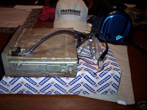

In response to your question:
The White and White/Blue wire won't show up on the car's schematic as they're for the speaker. Only one speaker for the early years. In the attached pictures the wires appear Gray and Gray/Black.
Take a look at the attached picture, there you'll see two more wires a Red/Blue and a Blue.
The Red/Blue is for the light that comes on with the Instrument Lights.
The Blue is the power wire for the radio. It often also has a noise suppressor coil in an in-line fuse holder either with or without a fuse. See the second picture for what the noise suppresor would look like.
The radio gets grounded through the chassis.
Hope this helps
E
