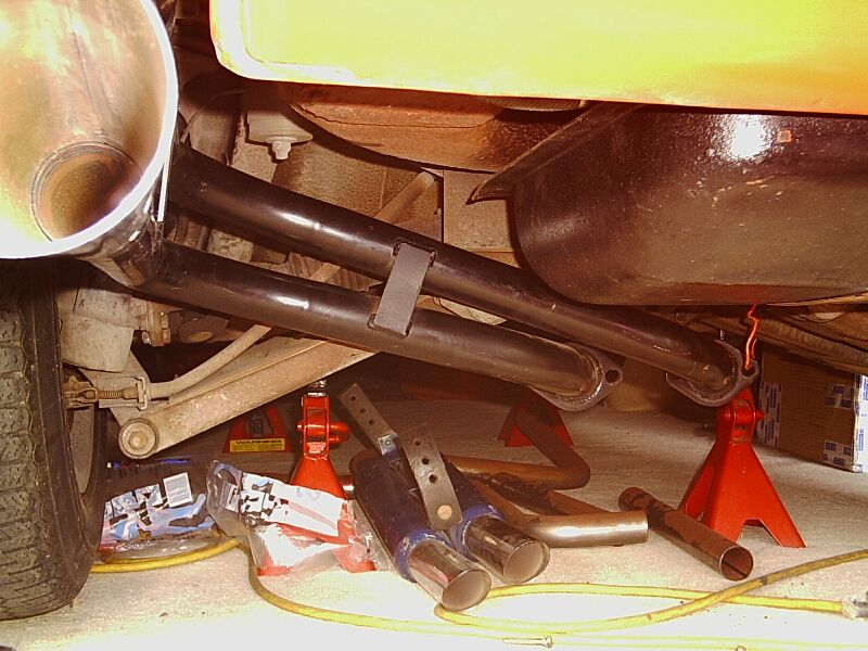

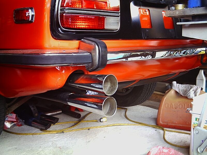

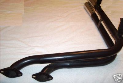

I have the twice pipes, It's not a good fit. I really like MSA and all the guys there are great but this system is not what it should be. The pipes are not bent right to give a proper fit. I have worked with them for hours and there just not going to work. The 2 rear S pipes going to the rear glass packs are the same size and bends. They run into each other. I'm doing this fit on a lift so the I can work with the system. They need a new shop to make the kit and to fit it to a real car. The set up seems to be a best guess as to what will fit. Now I just go hold of a rear megaphone system that was made by Clifford 6=8. It a new old stock set up, they don't make this anymore and I was lucky enough to find one. The pipes bends are not just good there perfect. Like I said, it's just the rear portion of the whole system. Two tube with 2 bolt flanges that tuck close to each other and side by side that fall just under and behind the rear diff. They then sweep around to the side and cross one over the other to the chrome megaphones the fit perfctly into the body exhuast cut out. I will post some pics this weekend. It's nice to find they took time back then to make a great set up. I'm going to copy them and use my glass packs for a street set up.
