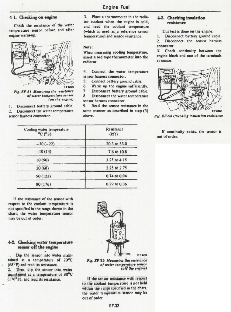

Good call, Will. I've experienced the problem he describes in my 810 and it turned out to be a bad temp sensor and it acted the same as his car is acting except for the clicking relay which kind of left me scratching my head.
Well I couldn't get an ohm reading from the temperature sensor so I took it out of the car. After cleaning the contacts with sandpaper it worked. Did the tests hot & cold & I think it works. Put it back in the car & started car up. Just as it started to warm up the fuel line after the filter split & started spraying gas over the engine. Luckly no fire. I'm off to get new hoses.
Vince
Well, if you couldn't get a reading until you cleaned it that should solve your problem since that's the same scenario I experienced with my 810. I cleaned the contacts and the problem dissappeared. I always keep some extra 5/16 fuel injection hose on hand for just in case.
