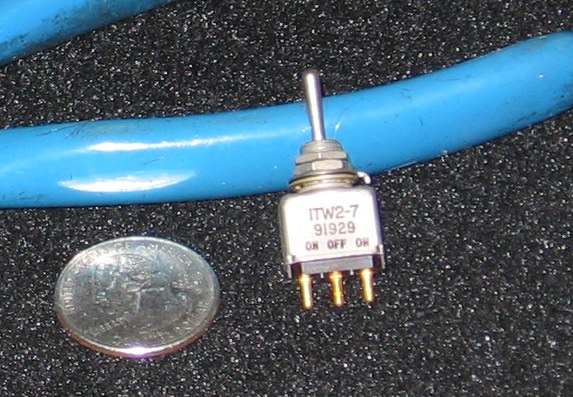

Thanks to you both. I'll post something after I run new wires. Mike, that looks promising. John, for the early cars the power antenna needs a switch to choose between going up and going down. It's not an automatic thing that will go down when its power goes off. I found the ideal switch yesterday, an SPDT, on-off-on toggle, momentary, and very tiny. Contrary to its description, the Radio Shack switch of this kind doesn't snap back to off, it's more manual than that.
The good thing about the one I found is that only the tiniest hole is needed. I'm going to mount it facing down, on one side or the other of the steering wheel, in the area of either the dash-lights dimmer or the trip odometer knob.
Here's a pic.
Steve.
