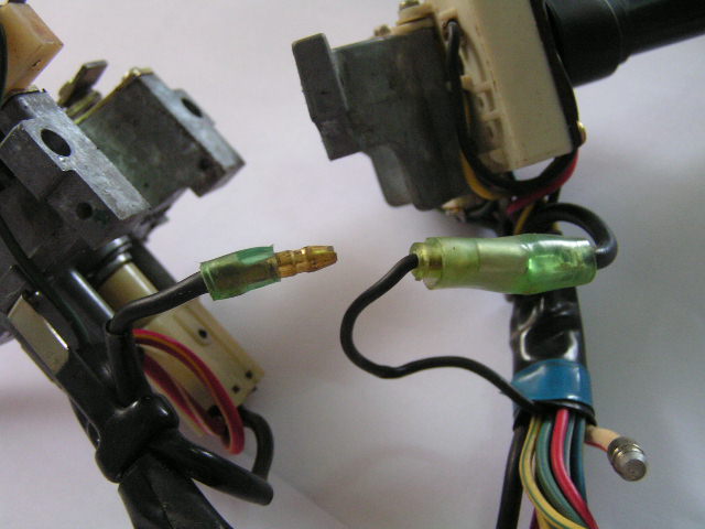

Step 1 remove the screws located on bottom of combination switch cover
(don't actually have a photo of this ) I din't actually have a bottom half of the cover.
Remove the top half of cover (lift up and pull towards you)

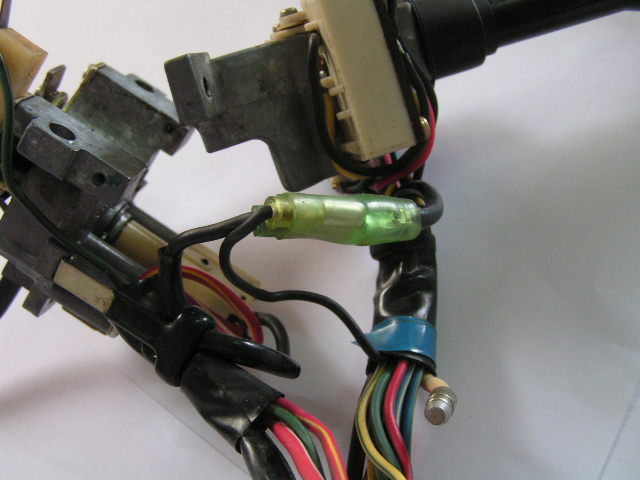

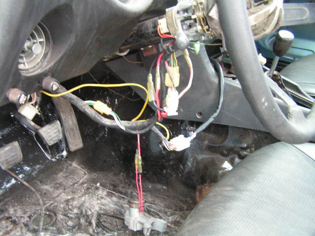

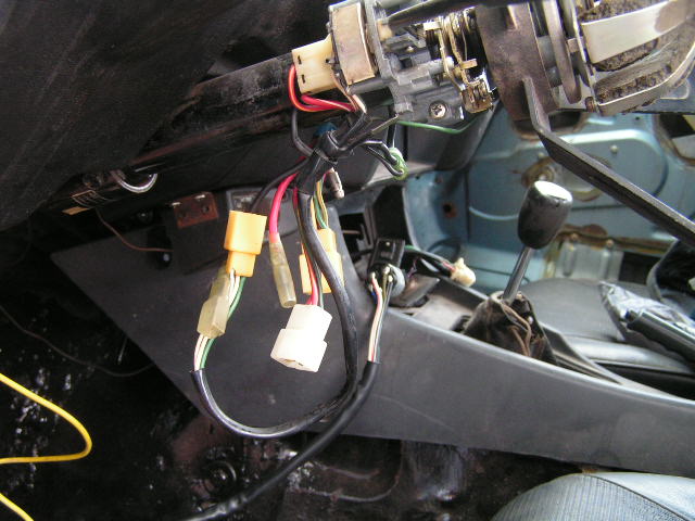

Step 2 examine all connecters below steering column . You could just take them apart if "nobody" has ever "fixed" them before. mine are apparently stock and there is no way you could hook them back together wrong (zzzt!)
Step 3 Undo all the connecters

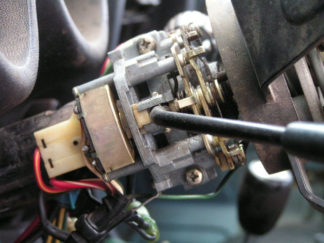

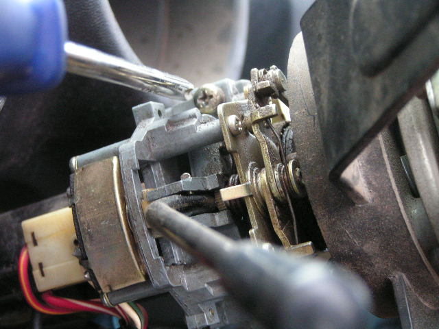

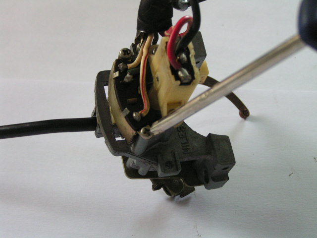

Step 4 Undo two phillip head screws on left side of combination switch (I recomend undoing bottom first but suit your self. support comb switch after bottom screw is removed first...so it doesn't fall off the steering column when top screw comes out.

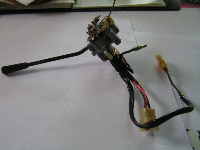

Step 5 take switch to your workplace. you will need small phillips screwdriver , offset needle nose pliers , sand paper or emory cloth , a really small flat blade screwdriver (headlight dimmer switch portion), can of contact cleaner spray , some wd 40.

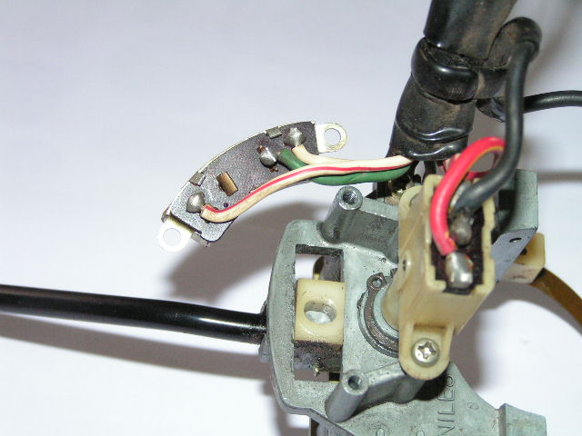

step 6 disconnect black wire coupling the headlight switch from the turn signal switch

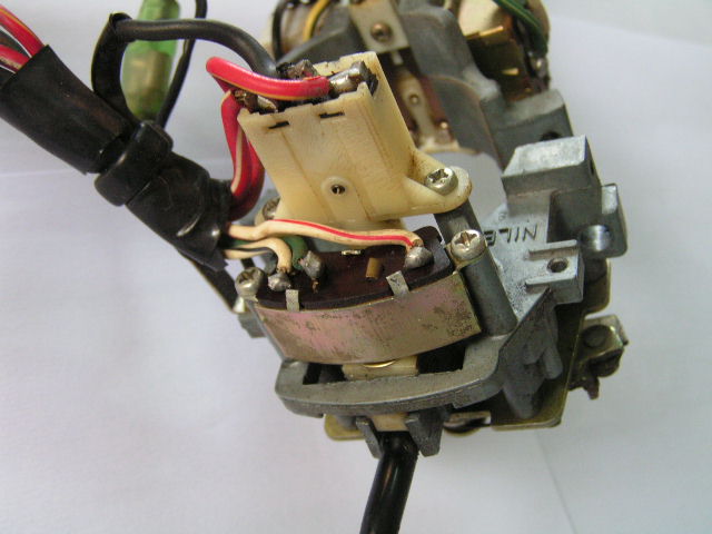

Step 7 remove two srews holding turnsignal sitch to turn signal combination switch assembly. pull up gently to seperate switch from assembly.

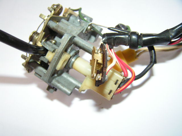

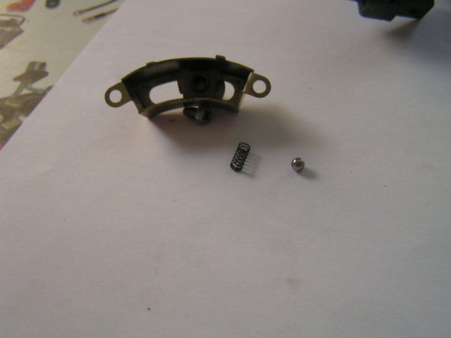

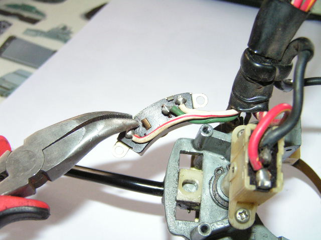

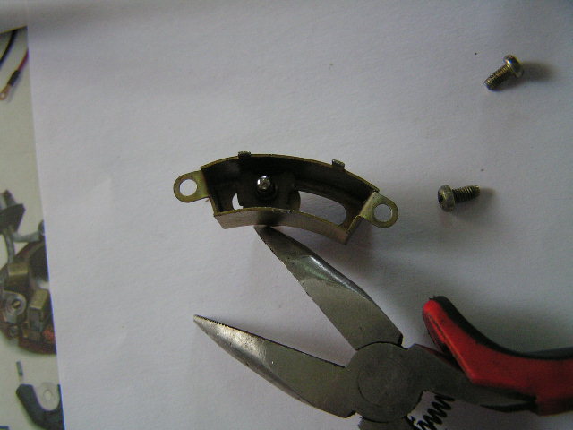

Step 8 pry metal tabs (using offset needle nose pliers), up so as to free the guts from metal shell. Pull gently on wires (yes the wires) to remove brown board looking thing wires are soldered to from the metal shell. you should see a set of points (kinda looks like a teeter totter on the back side of the brown board where the wires are soldered. and the metal shell has a sping and a ball bearing. The ball bearing sits on top of the spring. The spring sits in a little cylindrical receiver (hole).
Step 9 sand both sides of both contacts on the points.
Step 10 clean the ball
Step 11 clean the spring
step 12 very carefully stretch the spring a little bit (do not bust it)
Step 13 put spring back in whole
Step 14 put ball bearing back on spring
Step15 while supporting Metal shell with spring and ball bearing in a vertical manner, push beautifully cleaned teeter totter points thing back inside metal shell.
Step 16 while holding the shell and the teeter totter together and not releasing tension (so as to let ball bearing fall inside) bend the three metal tabs back into position.

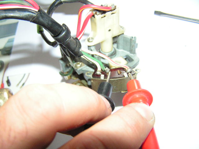

Step 18 Check for continuity (with a digital multimeter) set to "sing" ,sorry I cannot explain this any better ,but if you touch the two multi meter probes together the "sing".
18 a put turn signal switch in neutral position (neither right nor left turn)
Touch one multimeter probe to the middle soldered wire (mine is green)
touch other probe to wite wire with red stripe. no noise Good!
Now touch the white with a black stripe no noise? good!
now manipulate the turn signal to a left turn replace probe to middle wire and touch one of the other wires , Something had better sing. Repeat for right turn signal position.
