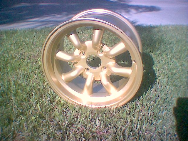

Yep, been there, Googled that. I was hoping for something more head on and mounted but I'm afraid that the best I'm gonna get. At any rate, I've decided to go with my first instinct with the solid gold rims at this point, besides, tehy shipped already. :) I'll post pics when they arrive. It may be a few weeks before I get them mounted.
Santa came early! I went with gold rather then bronze. They should look nice with the brown paint and gold pin stripes.
I also purchased the lug and stem kit along with the wheels, but it turned out that they are the tuner lugs and don't seem to fit the taper of the mounting holes very well. Certainly not like a full acorn style lug which has a larger tapered surface. Gabriel says it's not an issue but I am skeptical. Anyone else feel this way or have any issues with this?

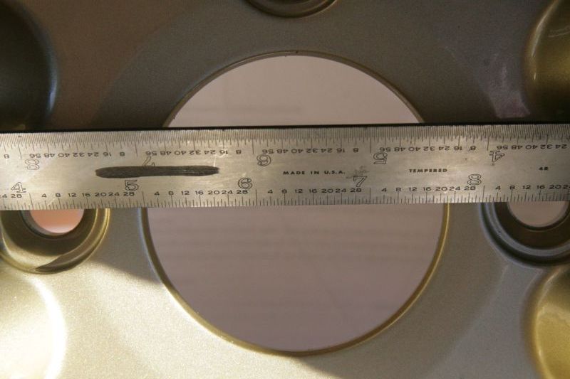

The counterbore is roughly 68mm depending on where you measure from. The measurement I took was using a flat edge and done by eye as 2-21/32" which works out to 2.656" or 67.468mm on the most narrow part of the hole, which is kind of hard to gauge.
Update: I attached a better pic from the SLR.
