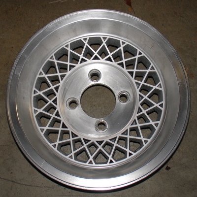

Nothing new from me. While I was researching this I got distracted and purchased a vintage set of 14x6 Appliance Wire Mags instead. So now I'm no longer looking into Konig caps, but preparing to order aftermarket caps for my Appliances instead, which are in the middle of being polished.

Arne, do you think that a silver paint would work on the interior spaces of the mesh and not look too tacky? I gave up on trying to clean mine. That was like work!
If you used a paint that simulates cast aluminum it'd probably look fine. I have already begun cleaning mine using a mild acid-cleaner designed for chrome wheels and hubcaps. It also claimed to be good for cast aluminum wheels, but warns against using on polished wheels. Sure enough, it really dulls the polished areas, but does a really good job of cleaning the cast areas.
There are two drawbacks to it - the obvious one of needing to re-polish the wheels afterwards, and also that while it will clean corrosion and dirt off nicely, it won't eat through road tar or paint. I found that some of mine had paint between the spokes, and the acid cleaner does nothing much to it. So I'm going to have mine dipped and stripped first, then polished. If necessary, I will paint between the spokes later.
