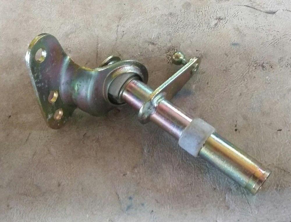

I looked into the bearing, and it gets cocked in the seat, so I think that's what is happening- you press on the throttle, the looseness on the bearing allows it to get cocked, and it stays where it is.
I don't think you can disassemble that part.  It should have been designed better, with a sealed bearing instead of a ball-and-socket arrangement.

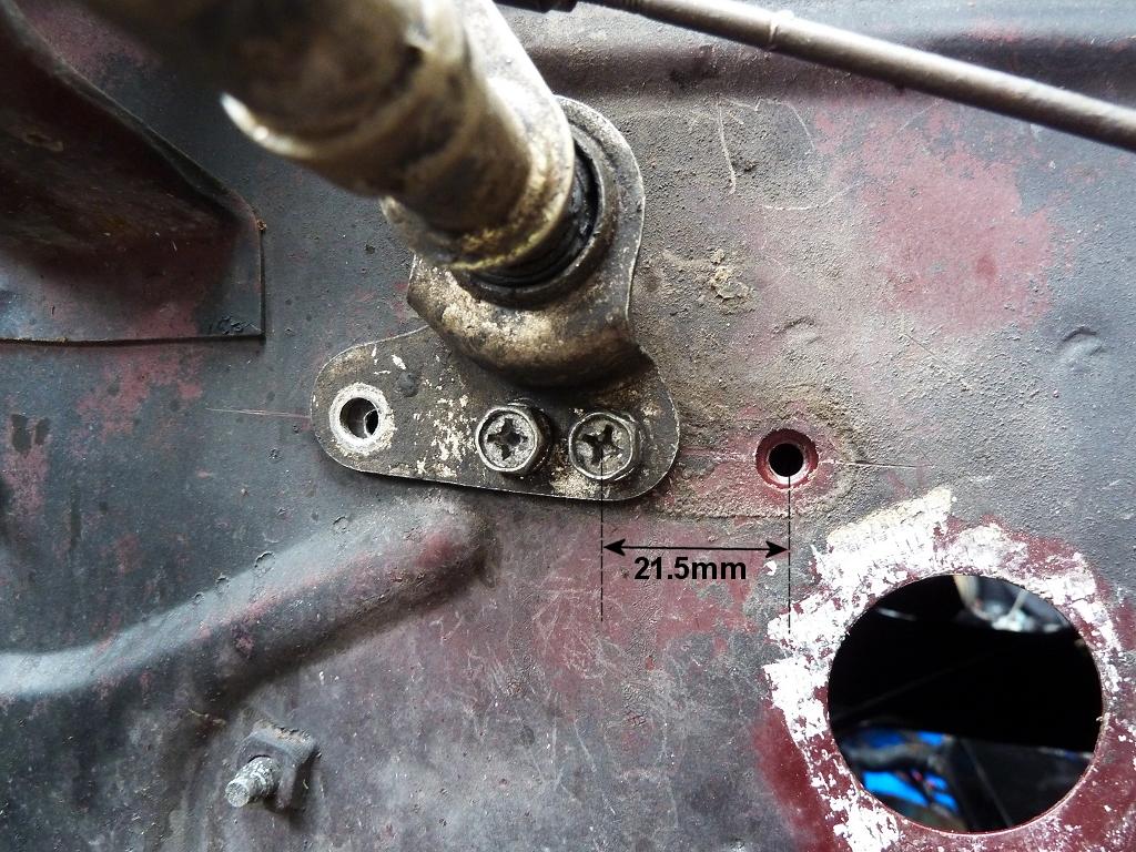

Edited by TomoHawk
I had to move that part above when putting SU's on my 280z.  Only the two outside 3 holes are used on the 280z.  The unused middle hole aligns perfectly with the left most captive nut  the when moving the part to align with the SU intake.
