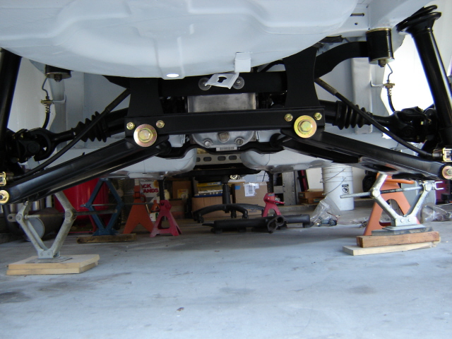

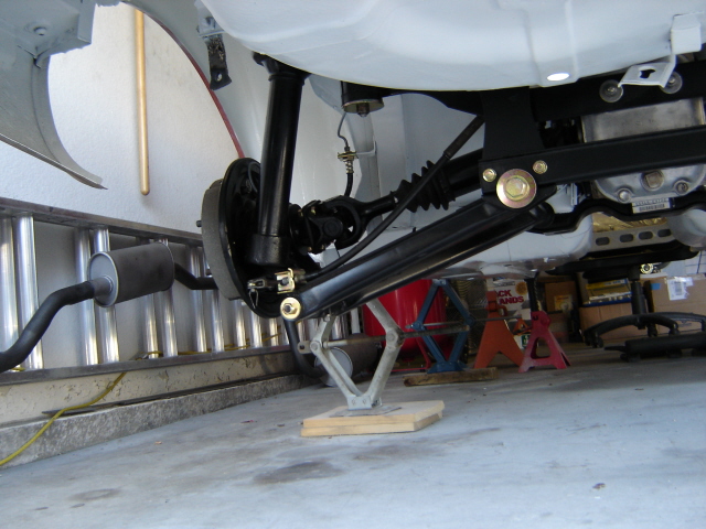

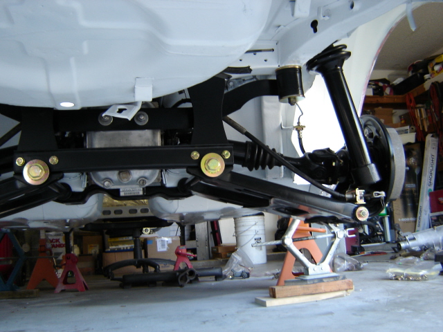

At this point I also have the suspension, brakes and engine done. I had the suspension sandblasted and powder-coated so everything looks nice and clean. Most of the components are stock, shocks are KYB.

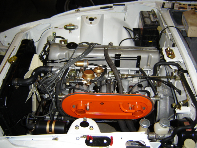

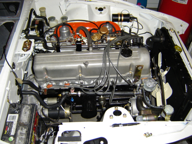

I had the engine rebuilt by a local shop that I've used before, total cost was $1,300. I had to assemble the head to the block, this helped save a few dollars plus I wanted to be able to say I put some of it together. I got a set of Z Therapy carbs, they sure are nice.
Today was a milestone for me, I was finally able to start the car and perform the initial engine break-in, I was relieved when the car fired right up. I did the 2,000 rpm's for 30 minutes routine to start seating the rings.

Wow! Looking good man. I wish I had that kind of time and motivation......The results are amazing. Did you plate the fasteners yourself or get them professionally done? Also, is that a simple bead blast/clear coat finish on the valve cover or paint?

I agree that it looks great! And I, too, am interested in your plating. Especially the emissions parts in the engine bay - they look good! I'm going to rebuild the air injection system on mine, and I have some NOS stuff (injection manifold and check valve), but some of the other parts I have not found, and would like to replate...

Enigma, I had the plating done by a local shop, it's yellow zinc per the ASTM spec. Good call on the valve cover, I had it sand-blasted and clear coated.

MDBrandy, I was LUCKY that my air injection system was complete and functional, otherwise I'd be searching for those parts also. Not all of the air injection parts were plated. I was concerned that the chemicals in the plating baths would make the parts unservicable so I used high temp gold & clear paint. I wish I had had the fuel rail and the air galley tube plated and I'll probably do that sometime in the future.
Yes, trying to replate the smog stuff would be real difficult. Was there any of the original stencilling left on the parts to try to match?
