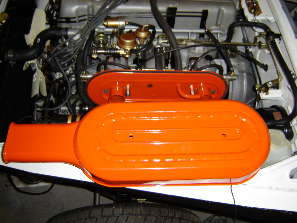

Chrome is a personal preference thing. It can look good. But what about the back of the air box? The part that faces the engine. There are lots of hose fittings and small tight areas that are hard if not impossible to do by machine so the chrome shop will have to do it by hand $$$$$. BTDT
http://www.classiczcars.com/photopost/data/500/medium/IMGP1039.JPG
If you have a local Powdercoater, check out their stock colors. When I was having my suspension pieces done I noticed the orange color below and compared it to the existing paint on my air-cleaner, my eyes couldn't tell any difference.
They sandblasted and powdercoated the air-cleaner for $50, their min lot charge.
