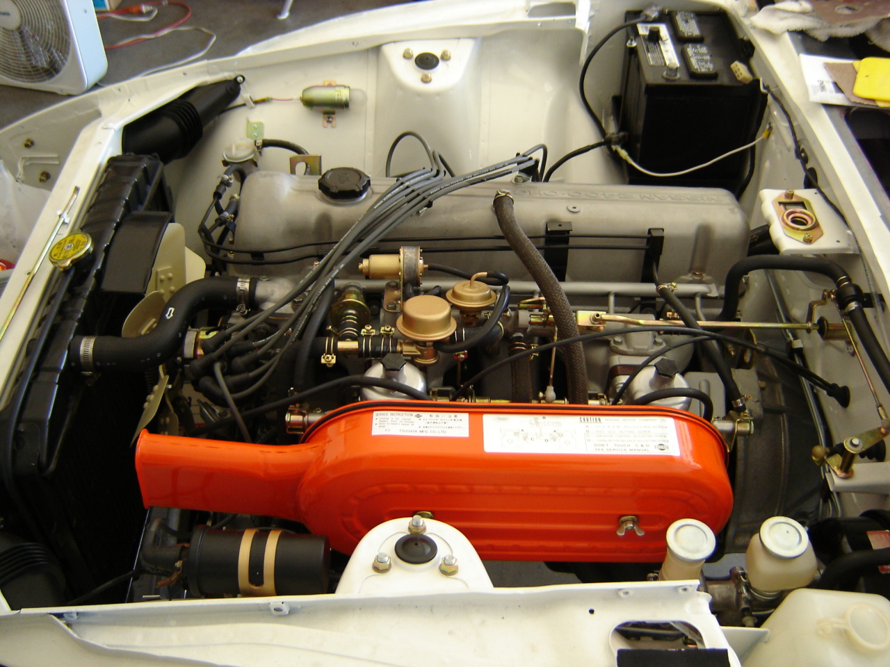

I first shot my cleaner with Chevy orange and it is as Ed said vary close to OEM . When I painted my car yellow the orange stuck out like a sore thumb and I didn't like the look, personal preference, so I changed the color to Chrysler blue the same as the block. This blue is again vary close to OEM Nissan block color. I have heard that some of the Z s shipped to Aus. had blue air cleaners . Gary

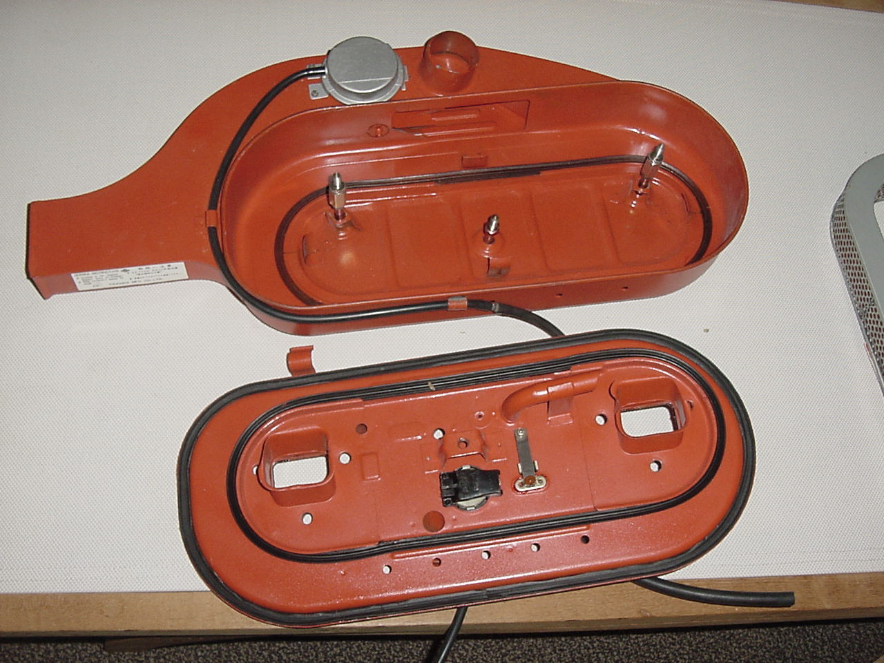

I seem to remember a similar post I didn’t care for the chrome air cleaner so went more stock. I found a close match for the air cleaner’s outer foam packing at McMaster website; I didn’t save the P/N. Media blasting shouldn’t be a problem; I used paint stripper and oven cleaner with good results. Primed and painted them got the decals from Banzai Motors http://www.zzxdatsun.com/
I used the following Duplicolor paint

Dupli-Color® Engine Enamel
An early post suggested DE 1621 Old Ford Blue for the engine block and DE 1634 Low Gloss Black oil pan and engine mounts.

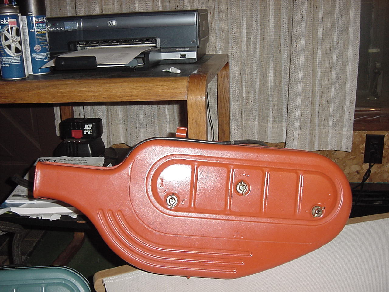

I personally used DE 1607 Chevrolet Orange-Red and then a clear coat for my 260z Air Cleaner.

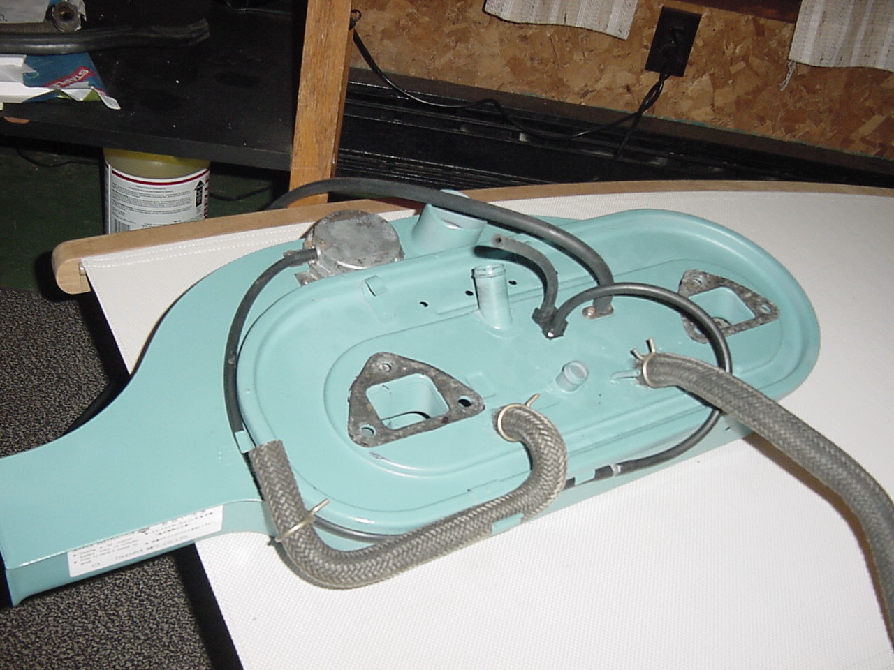

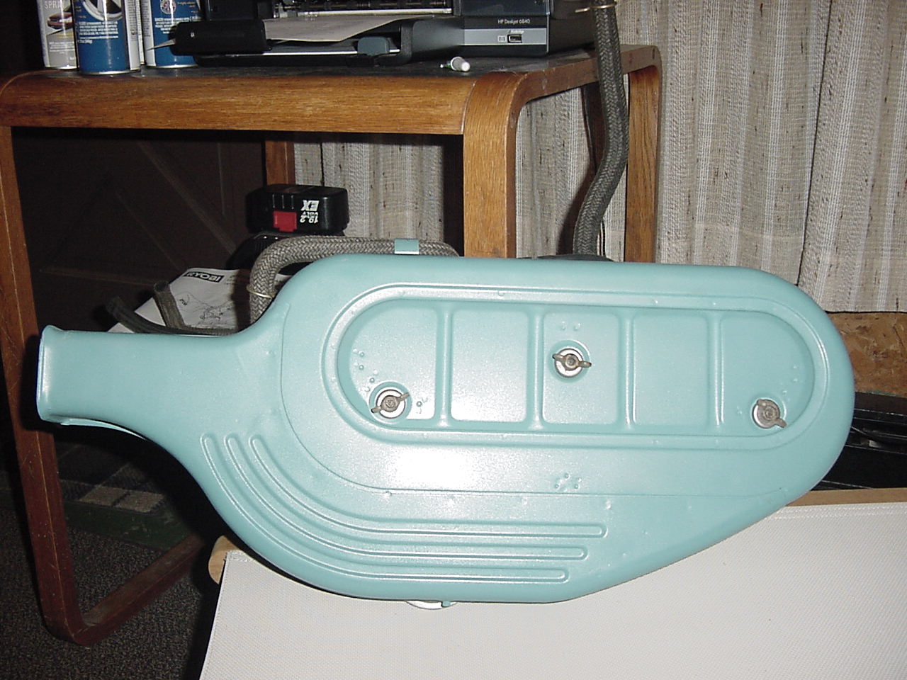

I also painted a 74 ½ Air Cleaner using DE 1610 Pontiac Blue (I used either a white or gray primer first) also used the same color for the vapor canister clamp. (picture posted)
