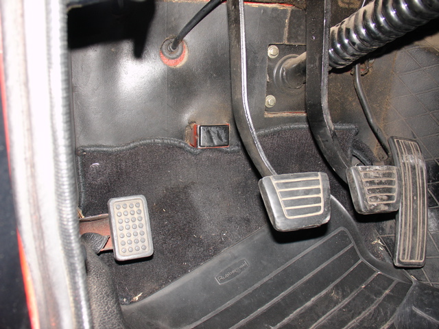

I'm still leaning towards the possibility that either the car was originally an automatic, or that the engine wiring harness is from an automatic car. The wires look just like the pair of back wires with bullet connectors that my automatic car has, and I note in the picture that the metal clutch fluid line looks hand-bent, not like a factory line.
Does your car have the rectangular clutch stop on the firewall as pictured?

Arne, yes, I do have the rectangular clutch stop on the firewall.

I know you decided to put this to rest but I just quizzed the local Z car expert on this and he thinks that it was indeed for an automatic just as Arne theorized. The two wires in question actually go down to the transmission itself - not to any accessory in the engine compartment; I'm guessing that this is for the starter inhibitor switch (can't start the car unless you're in park). That would explain the two feet or so length; they were probably hanging down after the tranny swap and the PO just moved them over with the other wires in the harness to get them out of the way. The bullet connectors are similar to the wires to the reverse lamp switch on my car.
He says that even automatics came with the clutch stop - it just wasn't needed. He also said that one practically guaranteed way to check if the car was an automatic is to look for the kick down switch at the top of the accelerator pedal arm since people making the switch would be unlikely to bother removing that.
