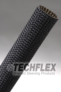

Now the dilemma is my hoses now look restored, but can they be trusted on a long road trip? For peace of mind, I am considering switching to new hoses and covering them with Techflex braided sleeves.
https://www.wirecare.com/wirecarephp1/wc_product_list.php?prod=FGN&prodline=ES
That way, I have the reliability of new hoses and the braided look of the originals.
