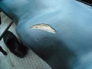

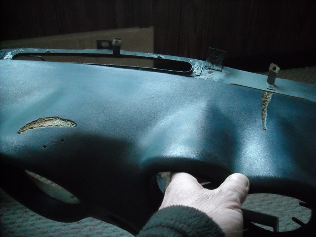

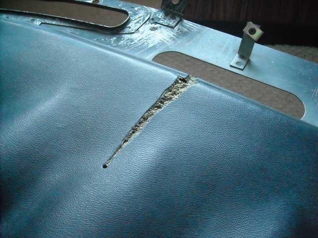

I'm just about to start restoring my dash with the methods from this thread but I'm wondering because my cracks are so shallow, can I go straight to filling them with body glaze or should I still fill them with foam or bumper filler?
Thanks,
Chris

Use a Dremel and cut up under the dash cover into the foam like this \ , instead of a straight up and down cut.   This will help with the filler from lifting.  You only want a very thin layer of Sem bumper filler. When you sand the repair ,tape off around the repair so you dont sand into the good parts of the dash.
