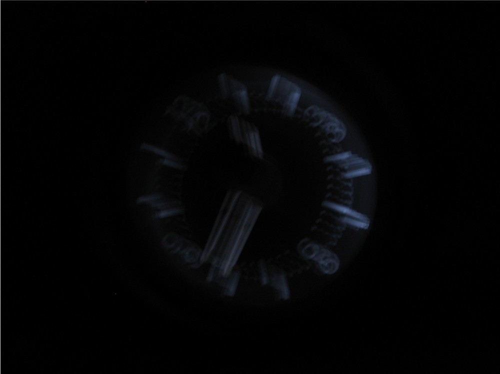

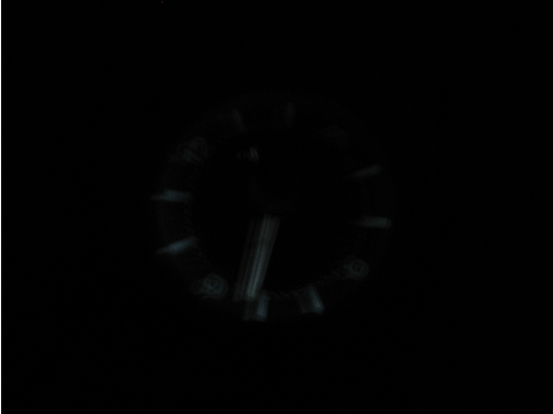

I took a spare clock and drilled another LED socket opposite to the other bulb socket mounted in the factory location. I also had taken out the green lens so they match.The attachment does not do it justice but you can see the difference in the amount of light emitted. I don't have a spare speedo/tach to experiment on but I may try it when I have the dash out.

I totaly agree with the "Looks better" opinion. After installing afew in the tach, it's much brighter, cleaner, slightly blue and definately more visable.
I've yet to install the others into the small gauges, but when I do, I'll remove the green plastic peice, to allow as much light as possible into each gauge.
