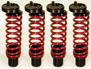

So question for you guys. If i go with the Racing Coil-Over Camber Plate Kit from motorsports and then adjustable Illuminas do you think it would be a good set up?? anythoughts???
The kit from MSA is essentially a Ground Control or an EMI kit. It would be best to go directly through them, you will get a better price, and they will be able to get you the right shocks. You will need to shorten the strut housings and use shorter inserts (shocks) to get the maximum benefit from a coilocer kit.
