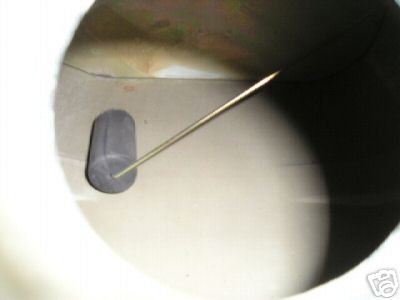

The filter is probably clogged-drop the tank! The problem you had only proves the problem is with the fuel intake-your tank is probably fUll of little stuf that uLtimately cloggs the pump(now the filter), and big stuff that blocks the pickup-thats why it runs again after sitting a while. It sounds to me like you will keep having these problems untill you drop the tank and get the junk out of it! I think you would be more effective addressing the problem rather than the symptoms. Dropping and cleaning the tank should get and keep you out from under the car and back into the drivers seat...

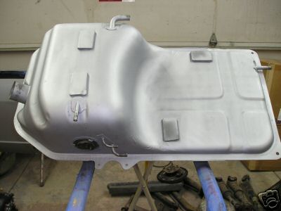

Dropping and cleaning the tank on all old Z cars should be something that is to be expected. I have learned this the hard way that the engines, systems are very finicky and require clean tanks. For less than $200 you should go ahead and have it done cause you will have to eventually anyway.
https://www.classiczcars.com/forums/topic/22361-wtf/#findComment-190167
I haven't dropped mine yet, either. The previous owner told me that he had boiled out the tank and that it was in good shape, but that wouldn't be the first whopper he's told me.....
I did drain the gas and it looked good, but you never can be too careful.
So, I went ahead and bought a clean tank on eBay, and it's just waiting in the garage for the party to start....
