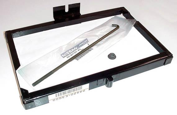

[/QThe hold-down in your picture is cheap, aftermarket cr@p. A picture of the factory hold-down is attached, it bolts to the firewall, and the J-hook goes down to where the battery support meets the fender well.

Yup. Right off the club CD. These are the numbers I gave my local dealer, with the local Z club pricing they give me:
Battery frame -- 24420-E4600 -- $13.98
Battery J-bolt -- 24438-21000 -- $3.15
Note that the J-bolt does not come with a nut or washer, those are separate.
