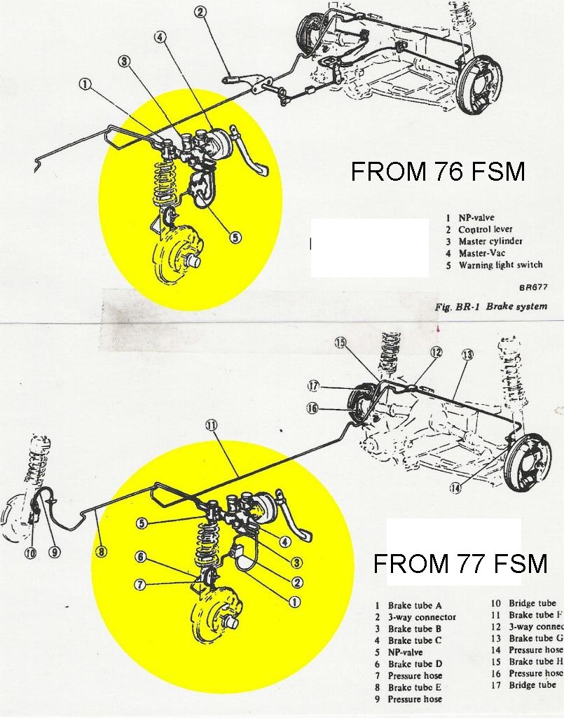

That may be true for a 240Z or even an earlier 280Z but not on a 77-78 280Z which has a three way connector in the in the area that you speak of since the warning switches had been moved to the master cylinder caps.
Stephen, you may be right. But I've seen info that stated the switches in the caps started in '78, while the pressure-type switch was used from '70-77. Since the original poster says his car is a '77, my info may still be valid. Or not, as I can't swear to it, and don't have access to a '77 280Z to check.
Well, I have a 78 which doesn't have the pressure switch but my info above came from a 76 and a 77 FSM. I also couldn't swear to it for a 77 or any other 78 besides mine but that's what the books say.
