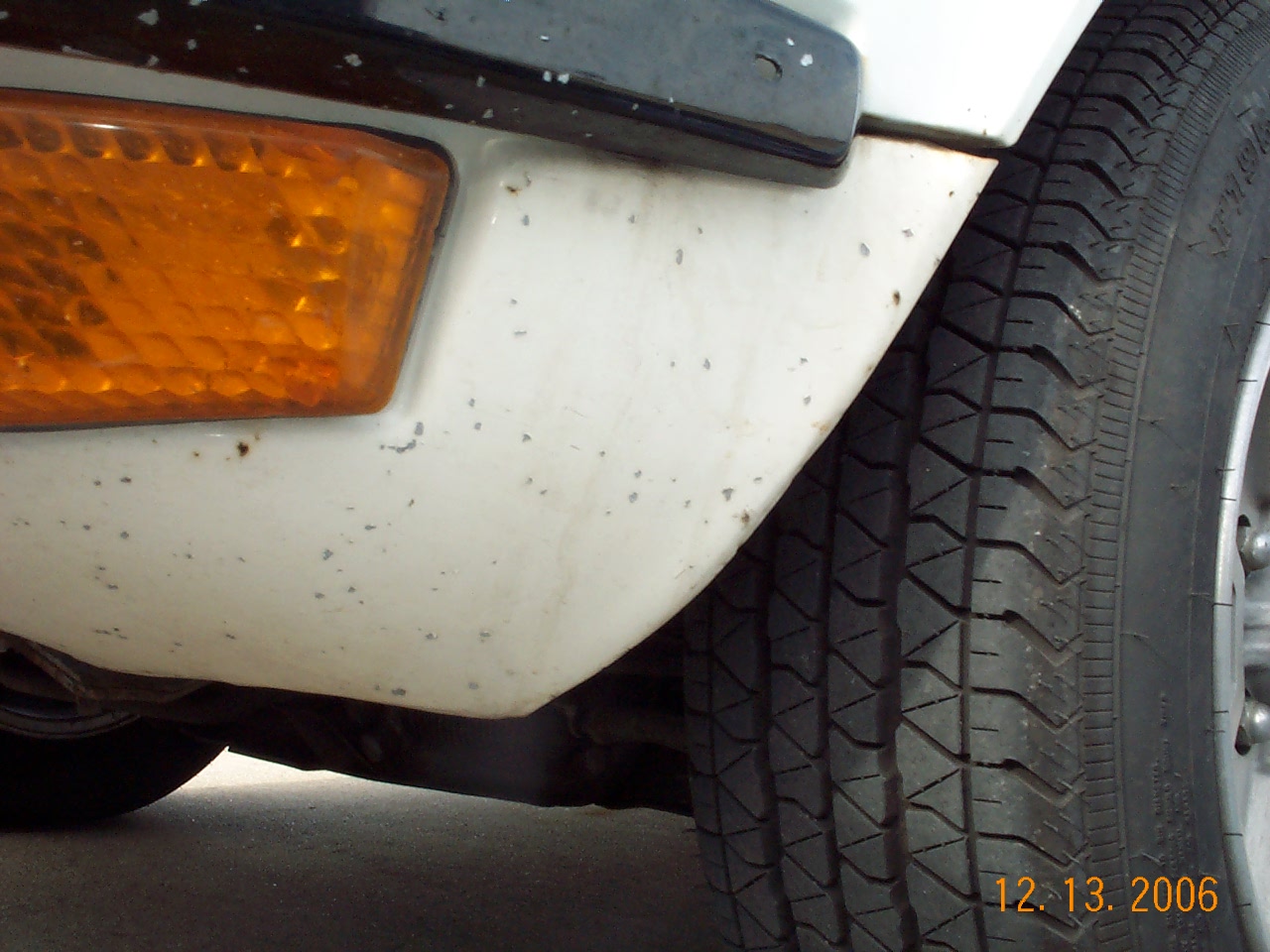

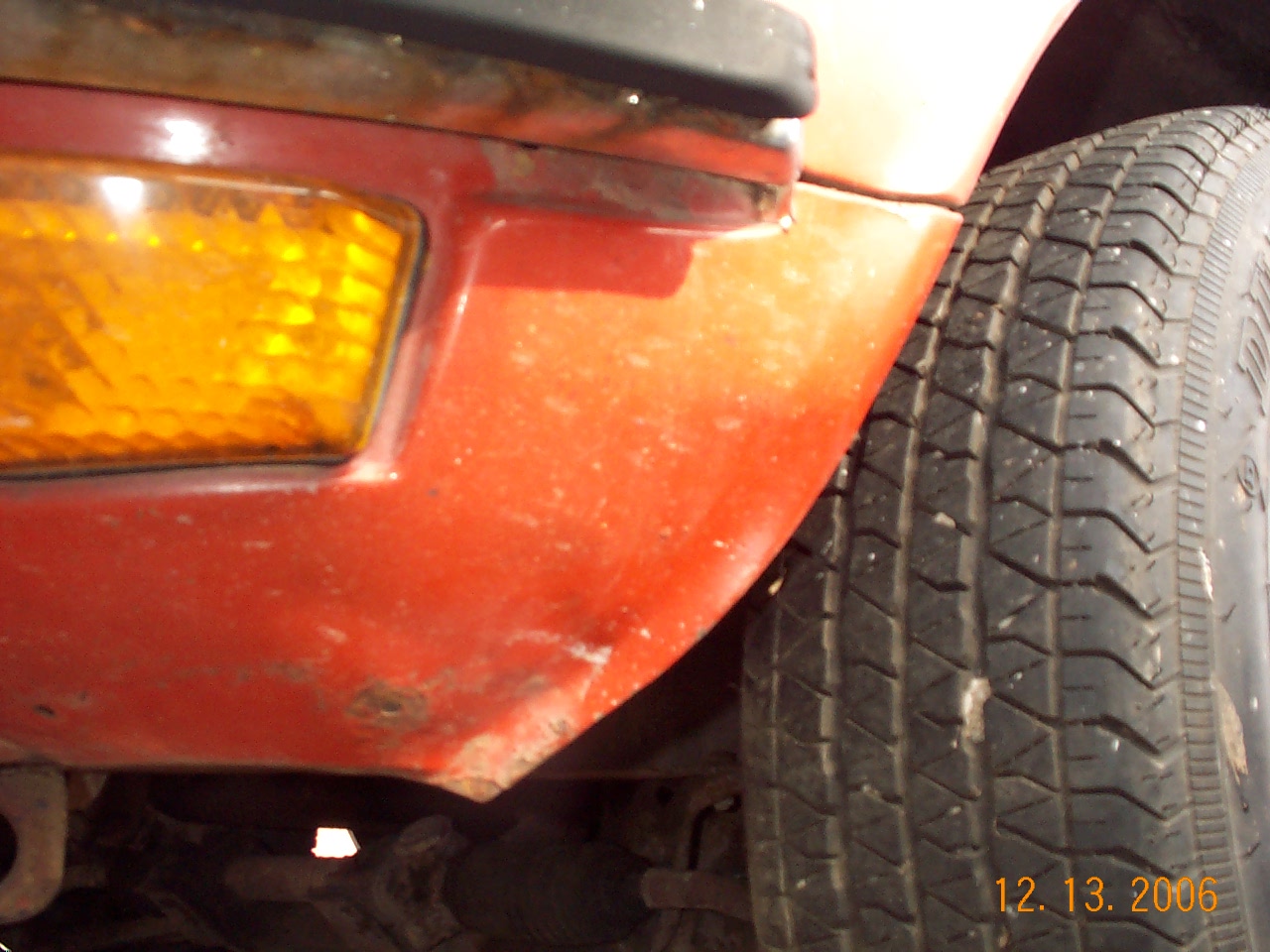

I happened to notice that there is a definite difference between the front valences on my 10/70 240Z (Jordan's Z Beandip) and my 2/73 240Z.
I apologize for the not so good pix, but I hurriedly shot them today during my lunch break from work. (It's dark out when I get off! :disappoin )
There is a concave flare on the 70 that is not there on the 73.
Does anyone know around what timeframe this small body shape change took place?

Hi Zup (everyone) :
I believe that the small body change was preformed by some previous owner.
I note the two holes drilled in the panel on the orange car - most likely they were there to mount a front spoiler, and the lip of that panel was bent out, to clear wider wheels, wheels with the wrong off-set and/or tires.

That concave flare at the bottom of the front quarter valance probably happened when too wide a tire was put on the car and a sharp turn was made, which caused the tire to grab the metal and bend it out.
