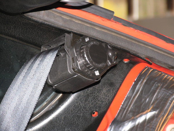

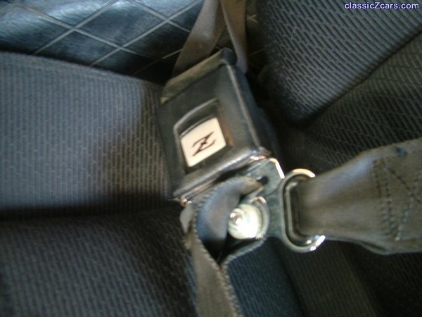

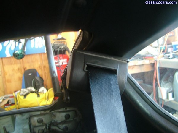

January 9, 200718 yr comment_195215 I took a chance, based on David's post, and ordered the 120" seatbelts from Wesco. When I mounted them, they did not have enough slack to allow me to move. The company is really good about exchanges, though, so I swapped the belts out for the 140" belts. I just received those yesterday, and I'll be mounting them soon.(History note: When I got my 73, it did not have shoulder belts. I got those from Autogator in Sacramento. I attempted to fit in some 74 seatbelts into the car, but the retracting mechanism would not fit into the pocket on the floor. Later, I bought the non-retracting seatbelts from Courtesy Nissan, but my wife didn't like them, and I wasn't crazy about them, though I thought they were better than 30+ year-old seatbelts.)Observations:It is good to have spacers on the shoulder mounts to allow them to swivel. Otherwise, the belt will not move easily.The belts are designed to have both ends anchor to the floor. I'm not sure if the early 240Zs with non-retracting belts have two anchor points on the floor. I mounted the retracting mechanism on the outer anchor point since it allows for a more vertical alignment for the retracting mechanism.I'll take pictures after mounting. Link to comment https://www.classiczcars.com/forums/topic/22637-retractable-seat-belts/#findComment-195215 Share on other sites More sharing options...
