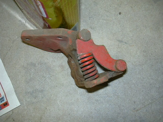

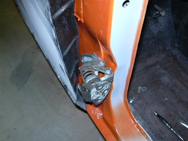

I am in the process of restoring a series 1 240Z build date 6/70. The lower door hinge full hold open mechanism has been damaged on both sides and the spring is missing on the passenger’s.
I tried to replace them with series 2 hinges but, the lower part of the door does not fit. There is a tapered gap from the top of the door to the bottom both front and back and the rocker panels have a gap or over hang of 3/8 on an inch. Removed the series two hinges placed them on the bench and measured the distance from the bench top to the center of the hinge pin. The series two hinge is 3/16ths of an inch taller then the series one hinge.
I reinstalled the damaged series one hinges on the car and the door fits as they should.
Has any one changed from series one to series two hinges and not had this problem?
Note series one hinge is on the left the seriers two on the right.

I've exchanged PM's with Jim (a7dz) about this and was in the process of changing the hinges on my '70 restoration project when I got the info on the possible problem. My doors are at the painter's being epoxy primed right now, but when I get them back in a day or so I'll try installing the later hinges I have and hang them on the body to see what happens.

On a 240 hinge there is no adjustment in and out from the door post (except to shim the door further out). The hinge mounts to the door through a tight set of holes that do not have room for adjustment. I have taken the time to slot the holes on the series II hinge so the door could move in. The edge margin of the bolt hole on the hinge and the gap between the door skin and the hinge then came into play and I could not get the door to hang flush with the other body panels on the car. The adjustment in the hole as far as centering is not a problem. The gap is even all the way around. Having the center line of the hinge further away from the door post pushes the door further out at the bottom of the door. The 3/16ths of an inch at the hinge gets greater until you can throw a cat through it at the bottom.
I would not be asking this question if the original hinges did not correct this problem. The doors hang flush and centered in the hole with those installed.
My next thought is to get another set of series I lower hinges. If I can not find them then I can make a set with parts off of one lower hinge with a bad hinge pin. I don't even need a good one all I am looking for now is the mechanical full open mechanism and the spring and if I could just get the spring I can make what I have serviceable. Will take a little more work but, I am on for that at this point. I am thinking my best bet to find what I need is off of a passenger door. The spring and mechanical full open mechanism are the same just flipped upside down from side to side.

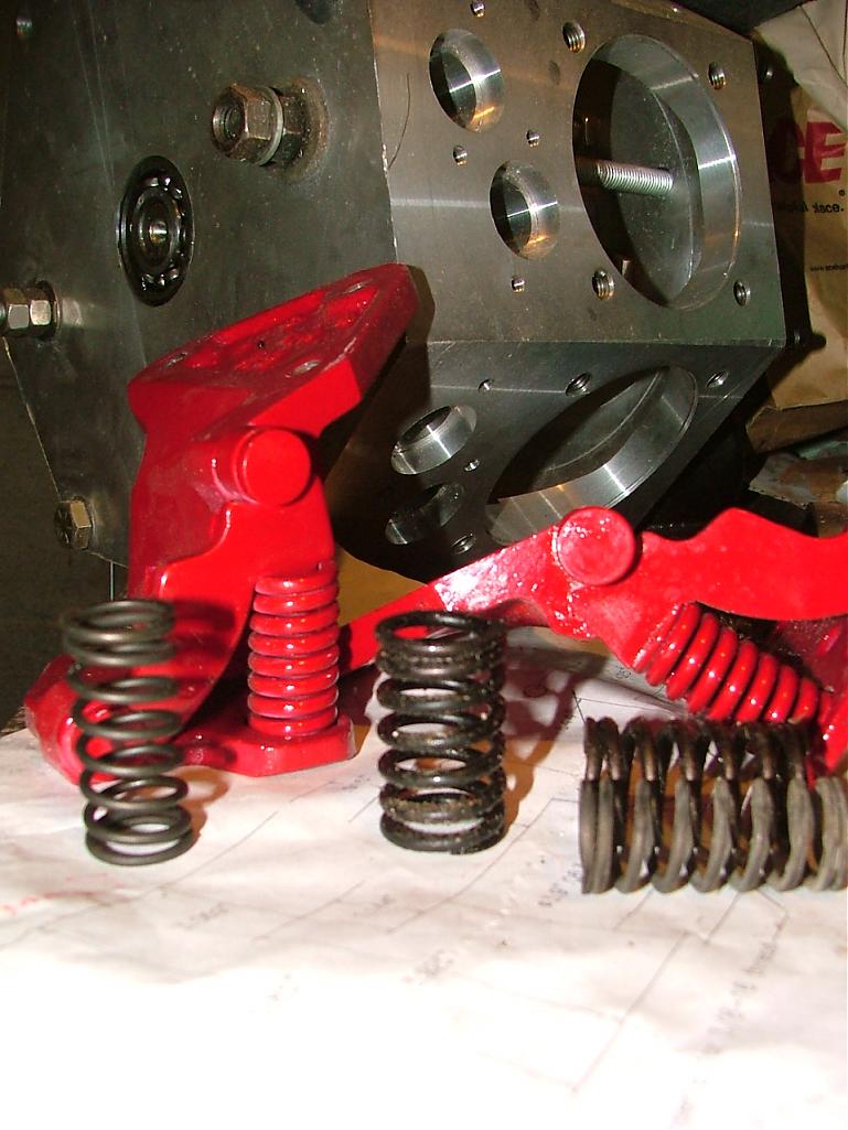

It would be nice to see the original hinges rebuilt. I've tried having springs custom made but it is 3-4x as expensive as buying something mass produced.(Big springs) Most custom spring mfg's won't give you the time of day for doing just two springs. Small springs like this are easily made on a lathe though. Just need some music wire of the right size. You might also be able to get away with modding an innerspring off discarded cyl head parts. (Cut to length and use torch to fold over new end on spring) I've got a ton of springs from heads. If you would like, take some measurements and maybe there is a match in the pile. Coil thickness, free height, etc..
