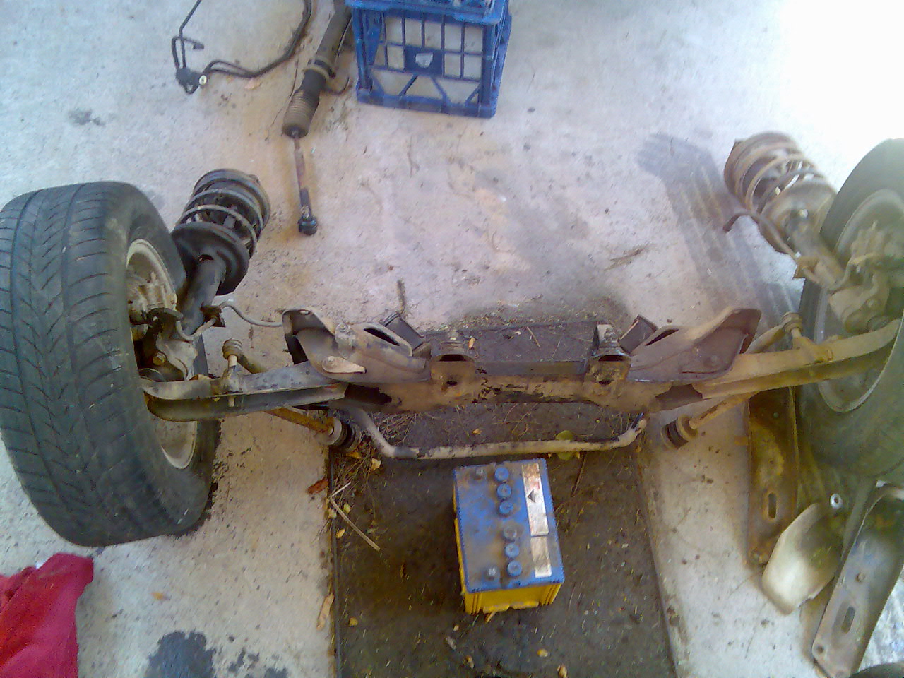

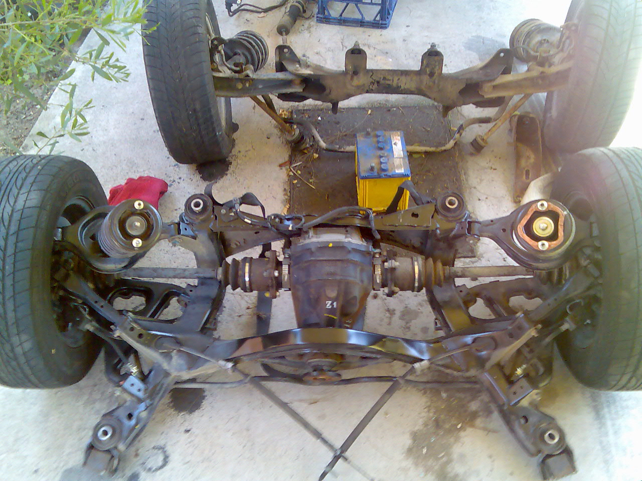

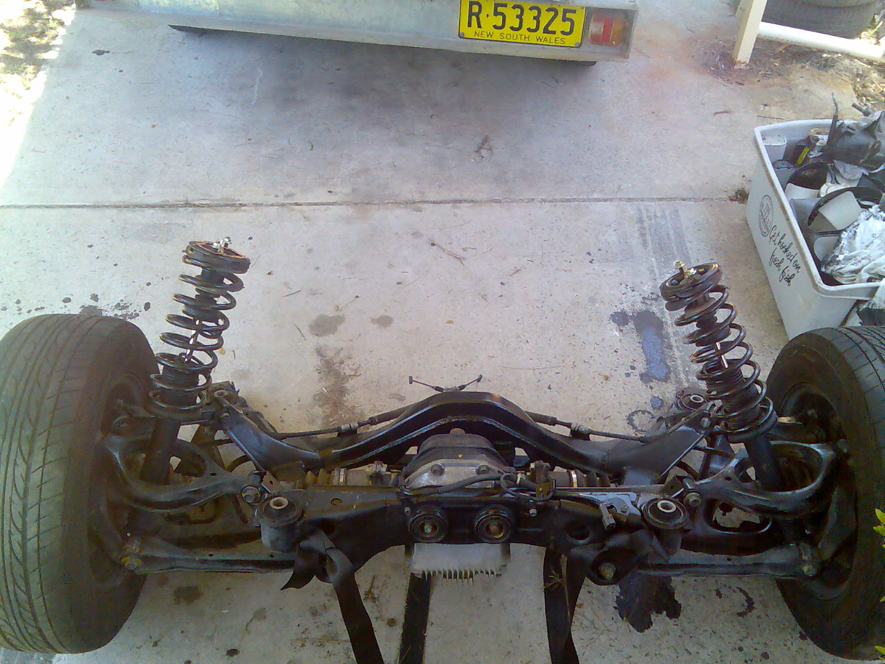

I'm putting the whole assembly from a 300zx LSD IRS into mine, I've been told it's a R230 diff (1.4mm bigger than a 9inch) but I cannot verify this as I know nothing about them. I've attached photos of the IRS assembly, I bought it deliverd to my house for $450 AUD including 6 month warranty.
With rough measurements it appears I will have to pump the rear guards 7cm each side :cheeky:
