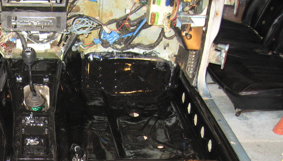

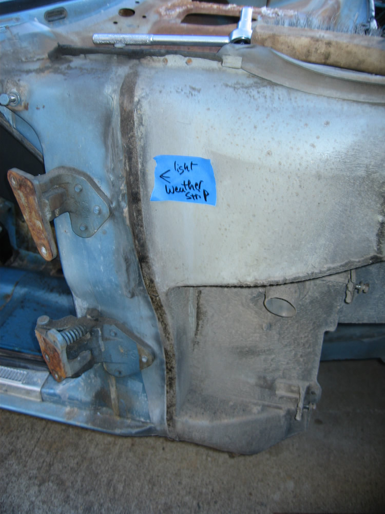

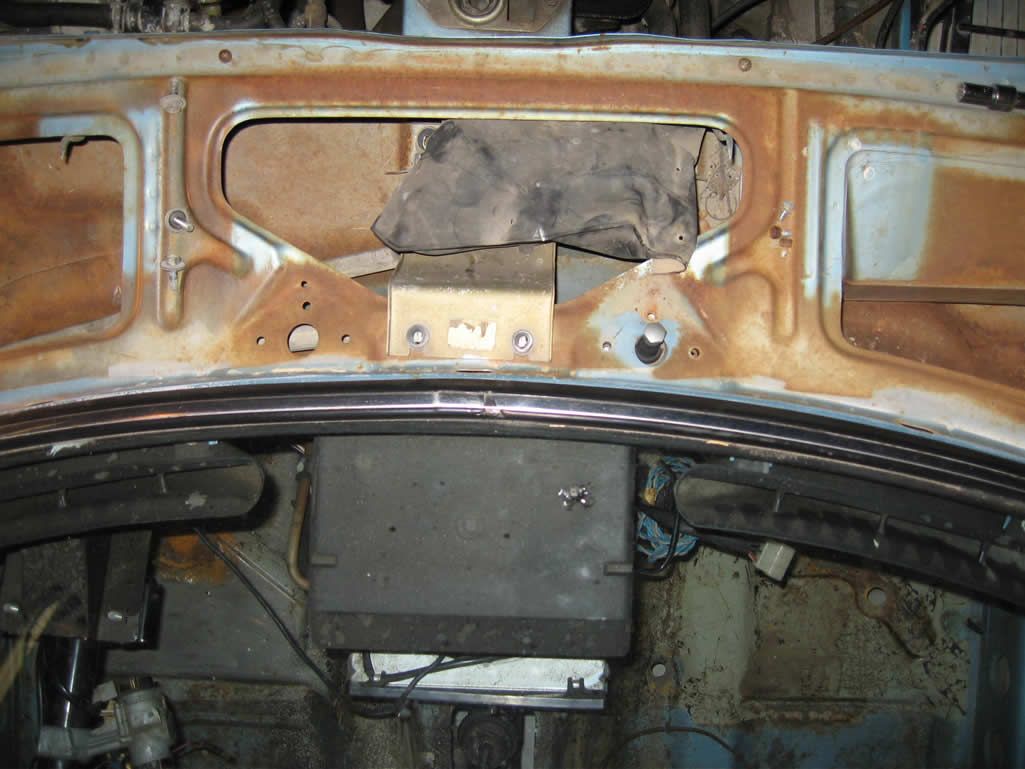

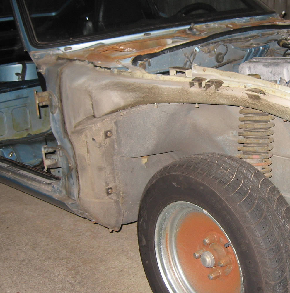

Since this seems to be a big issue which affects your ability to drive the car I would like to suggest some action you can take to find the issue.
First off, Strip the passenger side area of just about everything you can take out (Carpet, firewall insulation, heater motor, etc.) take the passenger side fender off along with the windshield cowl panel. This should have you to a point where you can really see what is going on with your Z and where there might be points of entry of water.
The process for elimination of areas which might be a problem:
1) Look for area's of rust which could have lead to water coming inside the car.
2) Use a powerful light (halogen laps work well) to flood the inside of the passenger area toward the car with light and look where you can see any light penetrating. Water can find more routes than light, but this still helps.
3) Use selective reasoning to decide where to pour water from a small jug on key areas. Do each area and test where the water is going. Use paper towels to test areas where you think it is coming in.
Personally I think it's leaking in from your windshield gasket (even if it's new) as the water can go from the top off the roof, hit the windshield gasket at the top, run all the way down, find it's way to the inner lip of the area (I know it can cause I had light rust there when I tore my Z apart) and then into one of the holes in the area. My Z leaked at the corner where water can pool due to the nature of the curves of the windshield. It wasn't a big leak, but in a good rain it would flood the drivers side.
I've included some photos of my z stripped down to help you reference some of the areas you might need to deal with.
Hope this helps and others feel free to comment with ideas or suggestions.
Thanks for your info. The carpet and sound detenator material is all stripped out on the passenger side. We don't think it is the windshield gasket that is problem because it seems to be comming in from under the cowl and somewhere into a rust whole in the firewall, but anything is possible. We'll see what this guy says today about. Thanks again for your help and your pictures.
