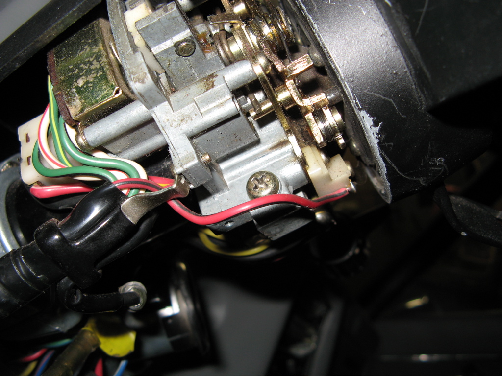

On my 1972 there appears to be a red wire with a black stripe coming out of the harness that goes to the turn signal assembly. It's hard to tell from the wiring diagram but since there's a relay that operates the horns I'm guessing that grounding the wire I mentioned actuates the relay. To verify, with the ignition off I just measured 12 volts from the red/black wire to ground. When I ran a wire from there to ground the horns blew. It just took me about 10 minutes figuring out how to resize a photo on this new Mac Mini. Oh well, hopefully the attached picture will help.

Awesome photo Mike. So there is on wire from the wheel to the collum. there is a brass "brush" that makes constant contact with the wheel... ill Have to look for it. If I can't figure it out ill let you know.
Matt

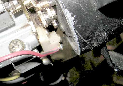

MikeW's picture shows the Red/Black wire going to the Brass Arm I was referring to.
In the attached picture I magnified and lightened a portion of his picture and you can just make out the curve of the arm.
That arm just brushes against the underside of the steering wheel, which then has a wire going through the hub to the horn button.

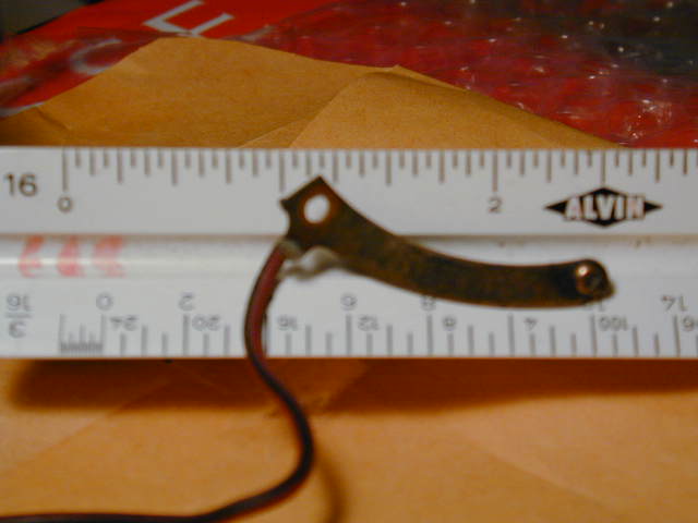

IT WORKS!!!!!! once I got the relay wired right the horns worked great! now all I need to do is make a little brass, (or some other flexable conductive metal) "brush" and connect the red/black wire to that and I will have a horn that works when you push the button. I could have used that about 10 times today:mad: stupid drivers.
Anyone have any tips on makeing a brush?
Thanks for all of your help guys! great relay explanation E.
Matt-
The brush can be made from copper or any other flexible, conductive metal solid wire. Just get a guage that is easy to bend but stiff enough to hold its shape. That should work in the interim until you track down a replacement part (if you care to do so).
