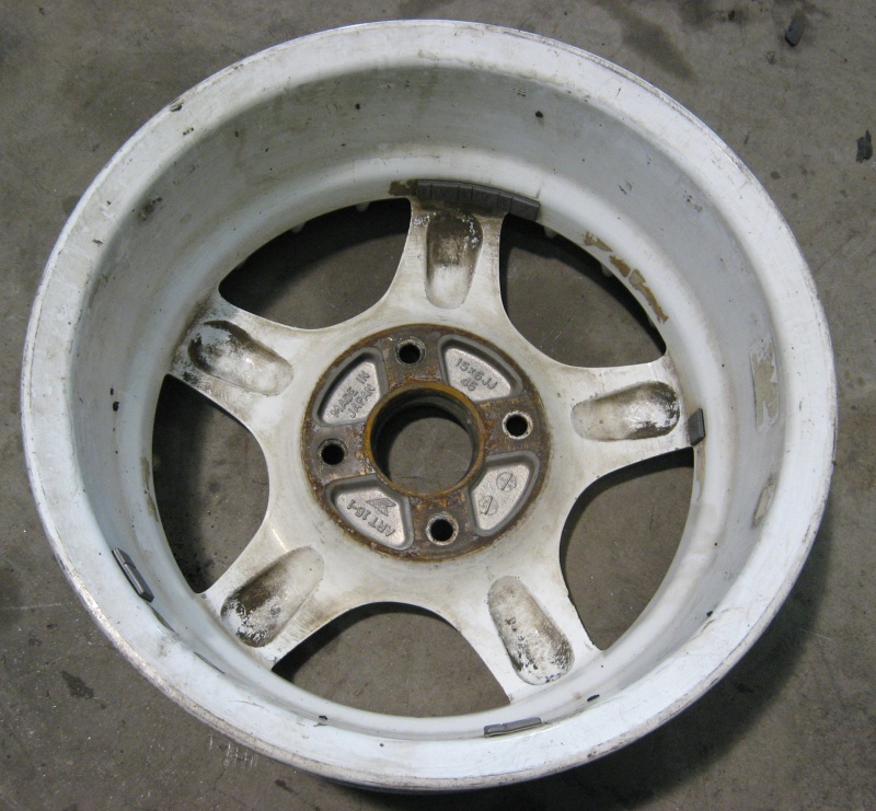

It's usually stamped on the back somewhere if it's there at all. A lot of times it will either be on the back of one of the spokes, or it will be in a recess on the back of the mounting flange between the lug nut holes. You can see the size information stamped on the back of this Advan Rally wheel I took from an eBay ad. You can see it says: 15X6JJ (the JJ tells you what the bead is shaped like-extrenious information for your purposes) 45 (which means it's +45 offset, negative usually has a little "-" on it) right there in between the bolt holes.
