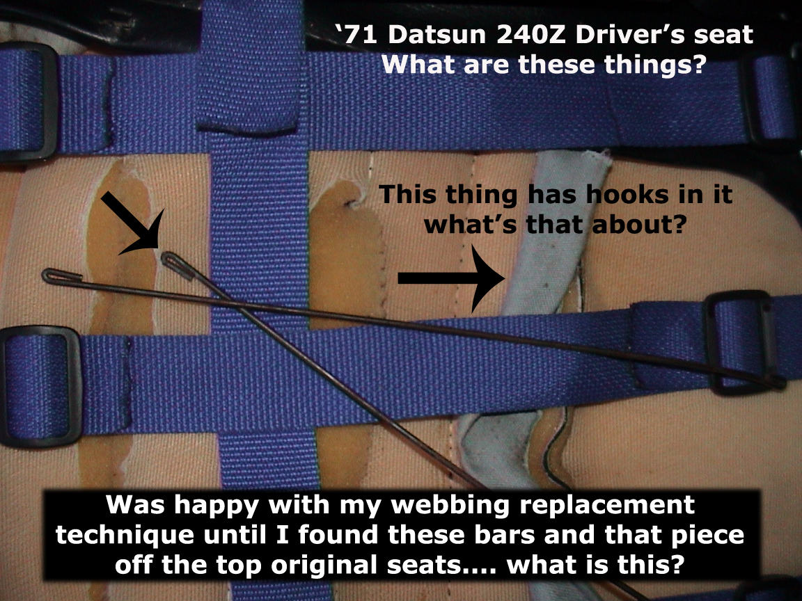

When you said "but you can do it yourself as the seats do come apart very easily" I sure got excited and popped right out there with tools in hand. Days later, still no go. Asked my husband to help so he may be able to work the magic I couldn't. Any hints? In our case, all the seats are quite fine, with the exception of the driver's bottom part of the seat which I want to refill with new foam and try to sew myself. Not sure it'll work, though. We're selling this family treasure, and wanted to make the seat better first. Here are some pictures that may be helpful.

Asta, looking at your pictures with the experience of someone who has a pair of '71s, here's my take on it. First, the seat webbing that supports the bottom foam is either shot or non-existent. You'll need to take the driver's seat out of the car and replace the seat webbing. (Webbing was only used in '70 and 71, springs from '72 on.) A discussion about replacing the webbing can be seen in this thread - http://classiczcars.com/forums/showthread.php?t=25479
Secondly, from my experience, I don't think you'll have much luck re-sewing that split seam in the driver's cushion, as that's not really a seam, it's quilted. There's no extra material there to re-sew. When you add in the fact that the reason it has split open is because it has gotten stiff and hard with age, and I really think you'll be better off buying a set of the replacement seat covers. They look great, and are soft and flexible - which the old originals are not after all these years. Replacement covers are between $200 and $250 for the set for both seats, and will be well worth it.
With new covers and replaced webbing, you might be able to get by with adding a bit of foam to the existing foam cushions. Replacement cushions are just under $100 per seat.

Hubby got the seat off for me and it's on the living room rug in all its splendor! There is no webbing that I can see, but do see the quilting kind of under the vinyl or leather, whichever it is. Also strange green-straps. I may well have bitten off more than I can chew at my age, tsk tsk. Alas, now that the seat is off, I must do something and will explore the information you've shared with gratitude.
