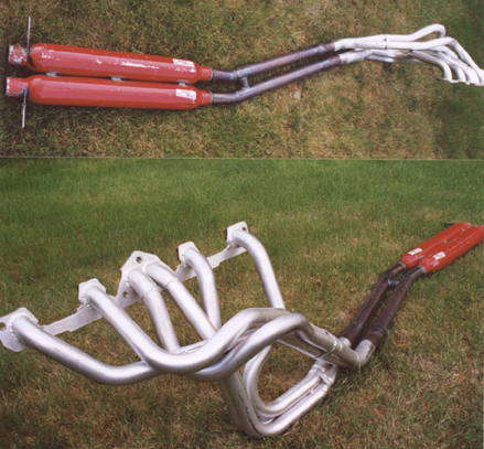

I use a Clifford Research (Clfford Performance) header with a stock L24, stock L28, and a L28 with a E31 & N42 head, and it has lasted well over 20 years. It was sold through Nissan orginally with their dual exhaust (in the early 70's). I beleive the header is still available, but the dual exhaust is long gone. It even had a option for smog fittings. Fits greaat, stock shield fits, however, you need to use a Nissan thick gasket. There motto: 6=8
Not sure how to contact these guys, but they make/made a ton of stuff for I6 for Jeeps, Fords, Chevy, etc..... They were located in Corona, CA. There web page was/or still is: cliffordperformance.net
Great product, if they still made that orginal dual exhaust that they produce for Nissan Motorsport, I would buy it in a minute. I had it on my Z in the 70's, the write up was " it would wake up the nearly dead"........:classic:
