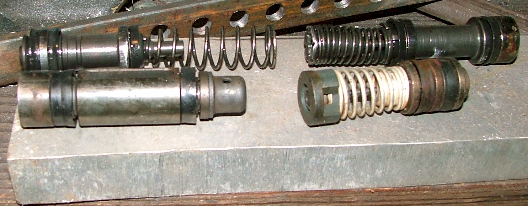

Here's a pic for comparison. The bottom is the pre-8/71 MC internals. On top is a Maxima MC internals. Both have the same bore but the thickness of the rubbers is different. It's funny that the thinner/lighter rubbers are for a Maxima station wagon.
Are you sure that Nissan is not trying to give you a later series MC?
Absolutely. When I bought my red car it already had the later style on it. I bought the early one from my local Nissan dealer. Gave them the part number myself, 46010-E4602. This was in November or December of 2006. Cost me $185 for the real thing, brand new.
