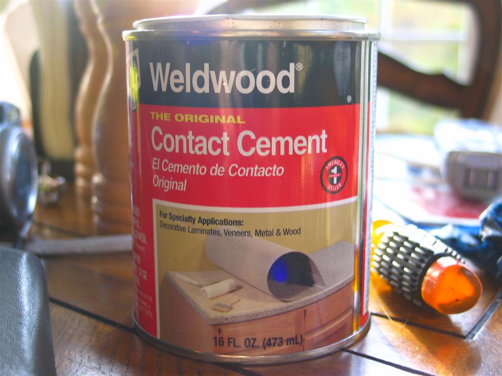

After eight months the doglegs have retained their chrome strips in perfect shape. No peeling or stripping...I talked with several local custom upholstery guys and they swear by contact cement for numerous applications. I used it on my rear wheel vinyl application and that vinyl will NOT come off!
So, I did the doors today as I previously outlined above.
--Buy a roll of 4" chrome adhesive trim from the local hobby shop. Cut strips 5/8" wide, and as long as the plastic trim (mine was 34 3/8")
--coat the middle third of the strip, then all three sides of the plastic trim where the chrome will go. I used a small 1/4" brush, but whatever works for you is fine. Coating the middle third ensures that the cement will be in contact with the top and bottom as well as the wide edge of the plastic trim
--wait at least 20 min for the cement to get appropriately tacky. Don't cut this time short, as the contact cement doesn't adhere well if it's still wet.
--press it on, maintaining the middle third of the chrome along the wide edge of the plastic trim. Pinch the top and bottom edges to get good adhesion
--after a couple minutes, trim the excess with a #10 or #11 blade
The Weldwood directions say max adhesion is at 7 days, so maybe don't bake your car in the sun until after a week's past.

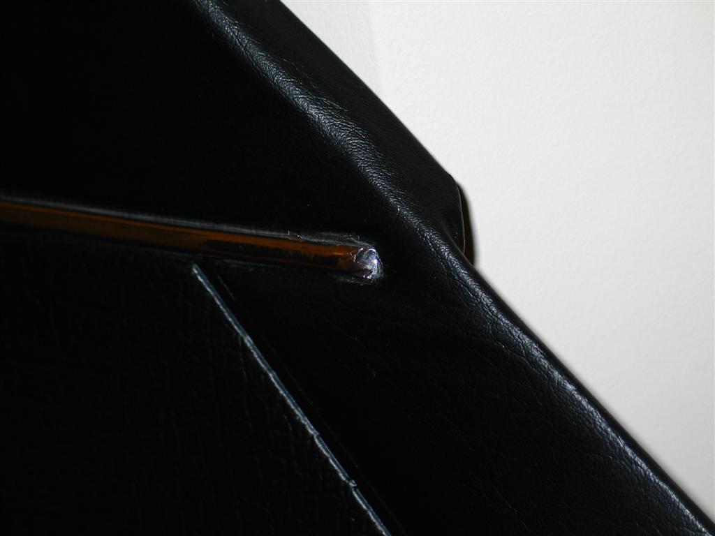

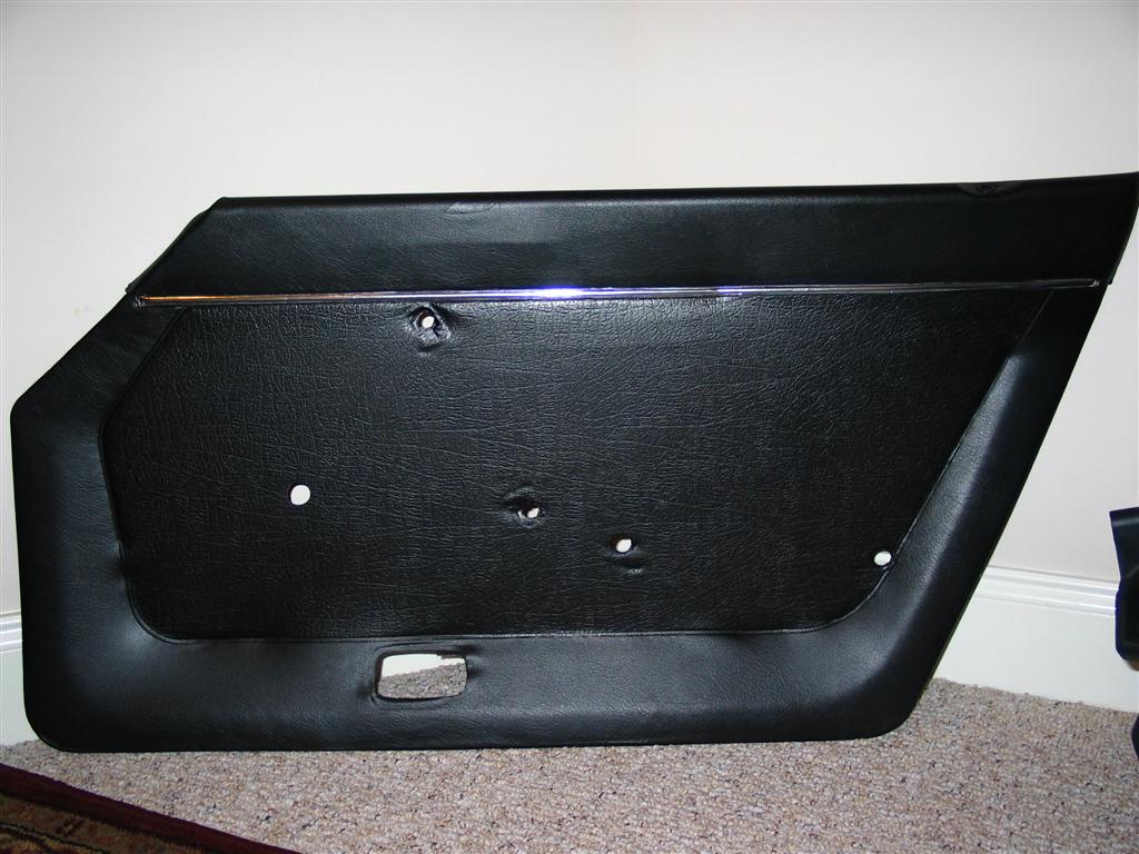

Here's the final result below. Looks very good, tight adhesion even on the beveled leading and trailing edge.
If you absolutely have to have NOS parts for your resto then don't do this. But, if you like retaining as many authentic pieces on your car as possible (like me), or you don't feel like parting with 700 of your hard-earned, rapidly devaluing dollars then this may be a good route to go.
