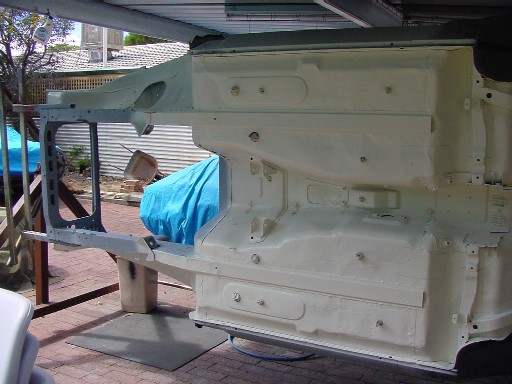

I have a '73 240Z which I have made a rotisserie to enable the car to be rotated 260 degrees whilst working on the body. This also helped greatly when it came to sandblasting, painting the underside and renewing the stone-chip material.

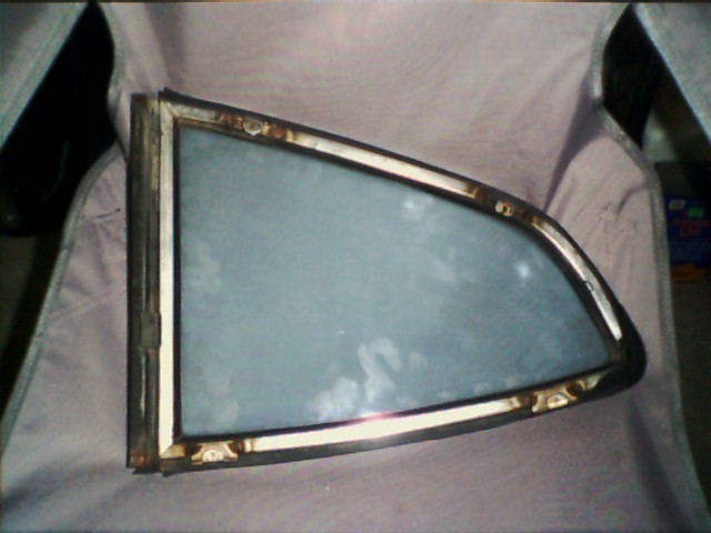

First on the rear 1\4 glass. There are four screws two on top two lower. If you have rust these are not going to be fun. I would say grind or drill the heads off the screws. Pull the glass out then deal with that rust. The glass will come out easy frame and all as one. I will put A photo in for you.

I don't have access to a scanner to be able to post pics of my rotisserie, although if any of you are interested you can send me a Private Message with your email address and I'll be able to email detailed plans for a zed rotisserie which another friend has built for his zed.

find attached some pics of my home made rotisserie, based on triangulated 65mm square ms tubing and 510 stub axles for the pivots at each end. It bolts to the rear bumper mounts and auxillary holes at the front of the chassis rails. Front bumper mounting points are too flimsy to use. Balance and rotation are :D. Email me if you are wanting construction details.
