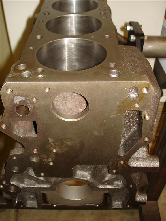

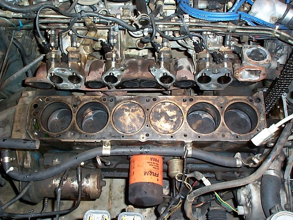

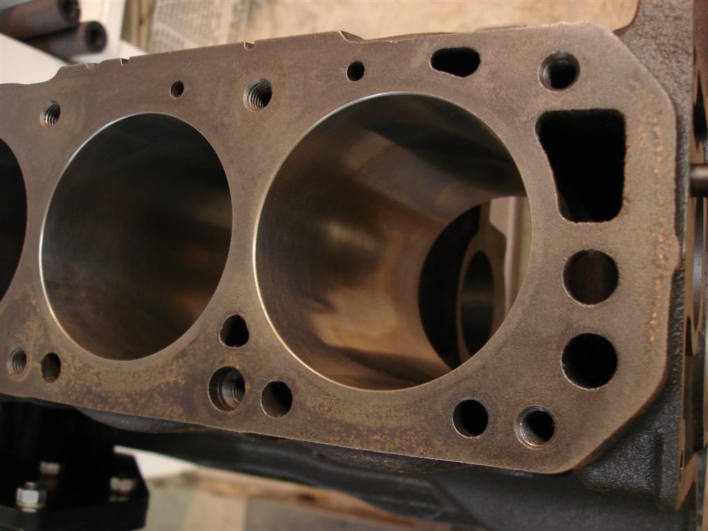

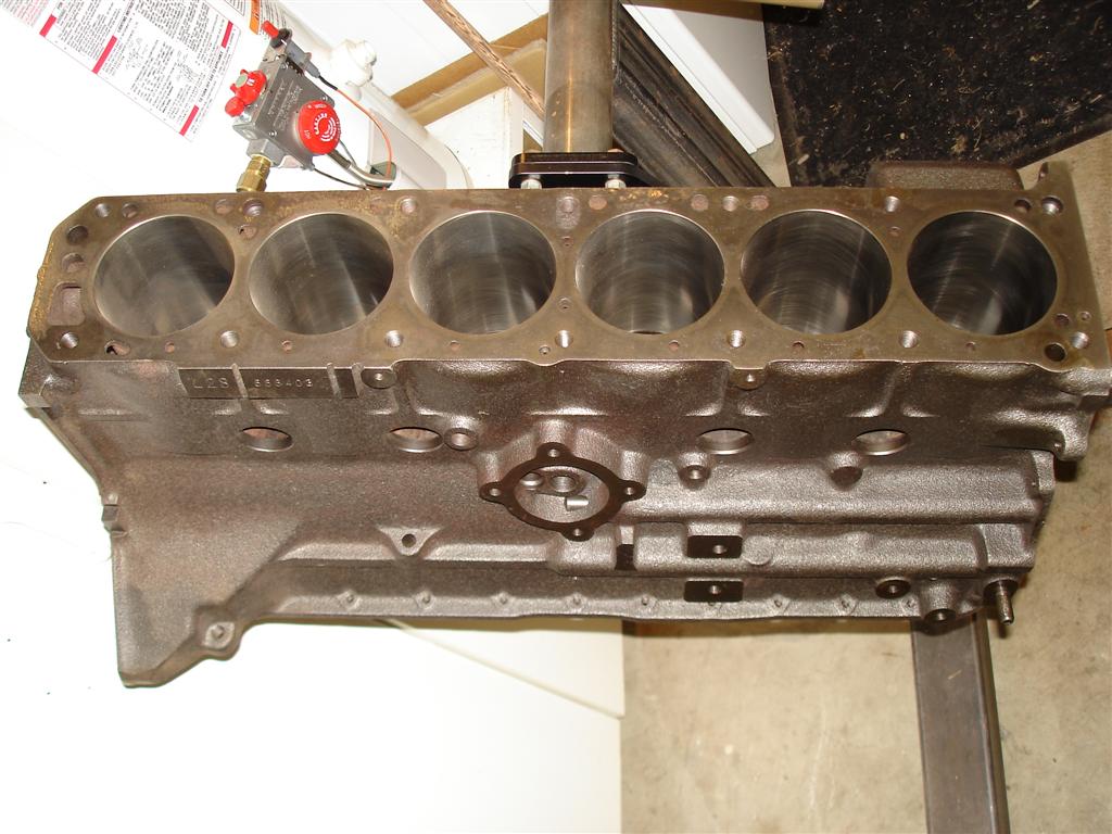

supra goddess Posted February 25, 2007 Share #1 Posted February 25, 2007 Sorry if this is in the wrong section I am looking for a picture of the block, view of the cylinders, water jackets and bolt holes from above. Thanks Link to comment https://www.classiczcars.com/topic/23424-l28-pic-request/ Share on other sites More sharing options...
Phred Posted February 25, 2007 Share #2 Posted February 25, 2007 Here's a few pics from Old Oregon. Phred Link to comment https://www.classiczcars.com/topic/23424-l28-pic-request/#findComment-200555 Share on other sites More sharing options...

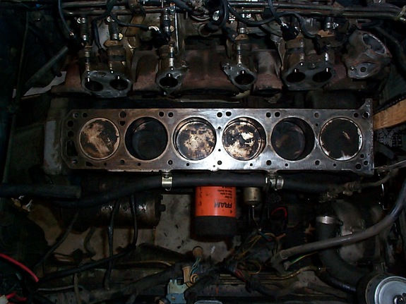

Hrududu Posted February 25, 2007 Share #3 Posted February 25, 2007 Here are some shots of mine while still in the car. Link to comment https://www.classiczcars.com/topic/23424-l28-pic-request/#findComment-200561 Share on other sites More sharing options...
supra goddess Posted February 26, 2007 Author Share #4 Posted February 26, 2007 Thanks guys! I really need to get ahold of one of these blocks and take some measurements for myself. Link to comment https://www.classiczcars.com/topic/23424-l28-pic-request/#findComment-200635 Share on other sites More sharing options...
