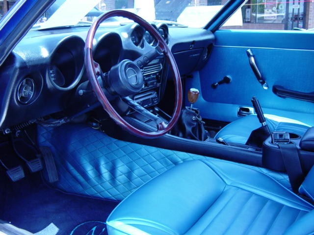

Stock class is the easiest class to lose points in than any other class (street, nissan mod, ultra) making it the hardest to get a high score (290+ out of 300)
Unless you have mis-classified your car (have a V-8 and put it in street mod), the only issue is how clean and well presented your car is as opposed to the others in your class. Once you move out of the stock class cleanliness is god (not close to god).

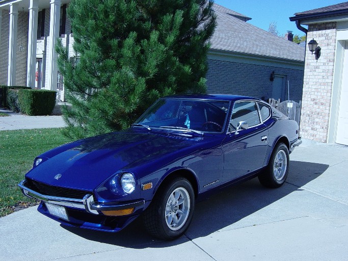

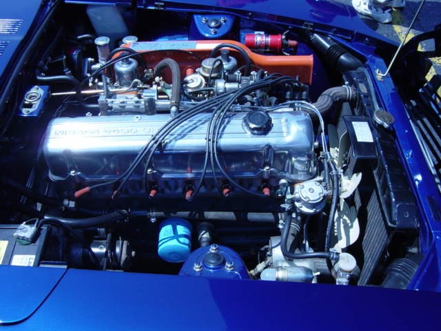

In stock class you are judged on BOTH the cleanliness and the correctness of the parts on your Z. From the three pics included of the 240Z Series I, it has the correct steering wheel but aftermarket carpets and a nonperiod correct armrest/cupholder. The metal fan is correct but the coil is not. Post more pics and I can walk you through any other items that will be considered a deduction. Those three items alone would lose you more than 10 points out of 300, then take points off for the usual wear and tear, grime, rust, etc. and you have a 270 car at best.
Depending on your competition you could win in your class with these items left as is. People spend hundreds of hours and thousands of dollars to make a "stock" Z stock as far as judging goes.
